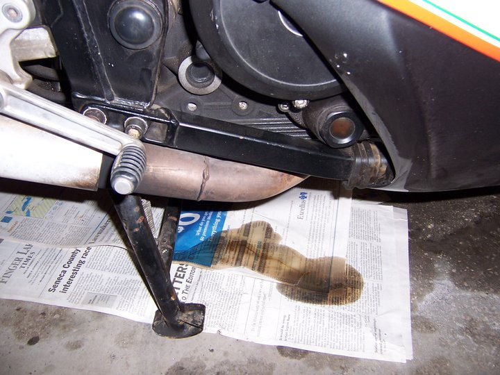

I will be working on the same thing. My 88 Paso greeted me this morning with this!!! Looking for Quad ring (X ring) ordering info from US vendor, or possibly a vendor for new slave cylinder.

A little steel wool and a new Viton o-ring and the slave cylinder is back in the bike and working great.
