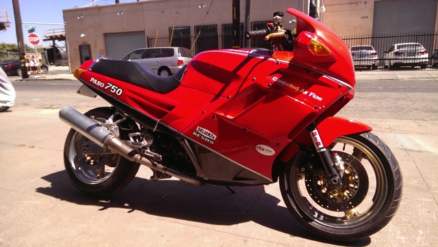

Happy Paso. New pick-up, merely 17 yr old coils and some refurbished fairings. Over 48K miles and she is still a beast. Thanks to gentlemen in this special forum.
