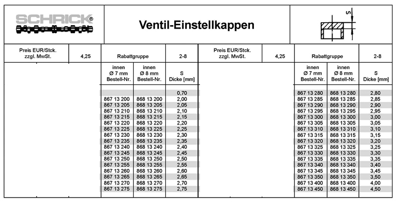

I doubt it but did anyone try to use 8mm valve hats for Alfa Twin Spark engines as opener shims for a Ducati?
After searching the internet a bit I found that a few Alfa & Citroen SM (Maserati) guys are using Duc shims on their engines so it must work also vice versa.
Lotus twin cam (Ford Cosworth YB) valve hats have an ID of 7.95mm and may fit as well.
They can be found for ca 4 $/GBP/€ ea. which is a third of Ducatis price.
Schrick cams in Germany also list 8mm valve hat shims.
Alfa Romeo & other alternative valve hats
- katalog_schrick_nockenwellen_2002.jpg (127.75 KiB) Viewed 12113 times

I sent an enquiry to AVL-Schrick and to http://www.maxrpm.de/, one of the shops here in Germany which sell the Schrick shims. Got no reply from Schrick yet but the owner of the shop sent me an email yesterday.
He wrote that from the open side to the bottom it`s 3mm (hence total shim height would be 3mm + "s" the thickness). The outer diameter is always 2mm greater than the inner diameter. As the shims were developed for tuned and competition engines the surface is hardened.

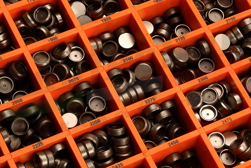

last update: I had posted in an Alfa forum to ask about the dimensions of the original Alfa Romeo (Twinspark) shims and they are od 11.5mm and 2.5mm depth.
They come in 0.025mm increments.
- shims.jpg (140.53 KiB) Viewed 12027 times
