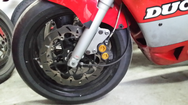

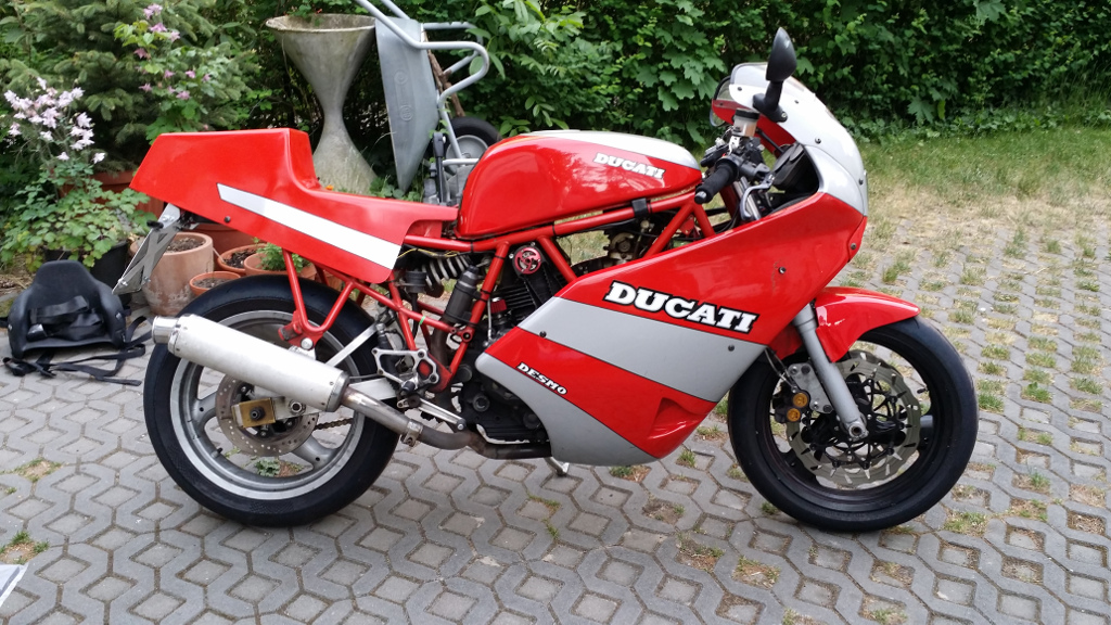

I want to show my 750 Sport. I bought it in 2013 in a
poor condition. After that I did several changes. Putting
17'' wheels in it. Front Brake caliper is from a Yamaha R1.
The rear brake is from the 17'' Duc. The heck is a
F1 Replica. I tried to lighten the Sport as good a I could
until now. This winter I'll try to replace the front wheel
by a lighter one. As well the rear suspension will be renewed.
I'll replcae the old shock absober by a Wilbers one.

Thats nice. What front wheel did you use
ducido
Posts: 7
Joined: Thu Jan 22, 2015 8:18 am
Location: Germany
Re: My 750 Sport
Post by ducido »
I used a 3,5x17 from a monster (or supersport).
I had to replace the the bearing
and put in a spacer, which ist custom made.

Nice. Do you have any more photos of your bike?.

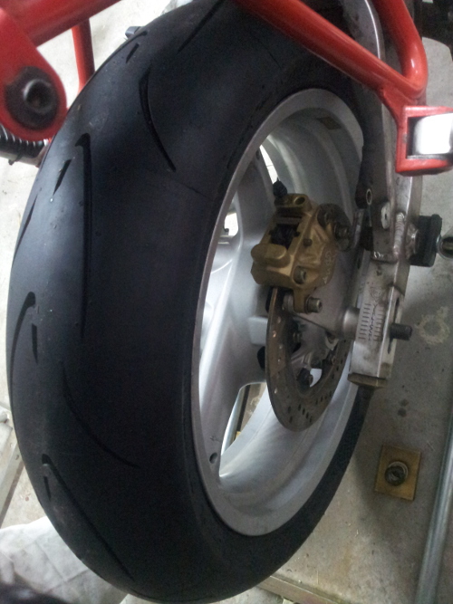

Here are pics from the front wheel, rear wheel and brake if have used.
I made some more changes. (Ligh fly wheel, ligh (alu) clutch, fork is
adjustable (made by HH Racetech), LiPo battery (self made) )
Currently I have replaced the rear suspension by a Wilbers one. I got
some NCR camshafts and probably I'll install them next.
I use the Sport mainly on the race track.

Rear Whell and brake from SuperSport

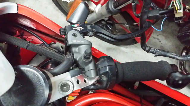

Nicely done mate. I'm always interested in photos of something special so lets see what you have. What's the bike next to the one in the second photo,TT?.What is the front master cylinder/brake lever off?.

The front break cylinder is a Brembo RCS 19. The front brake calipers
are from a Yamaha R6/R1 brake. As disc I used ABM Peack Evo.
