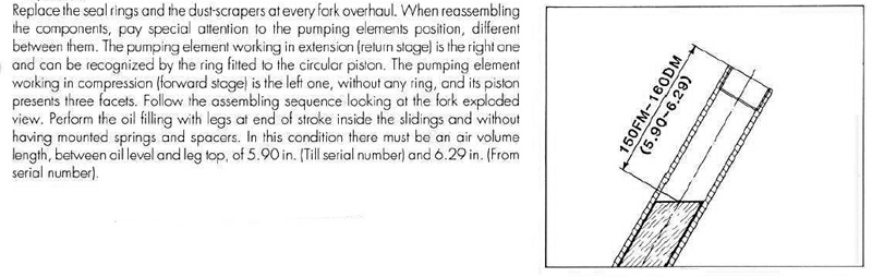

Rechecking my rebuilt forks and they don't feel as if working correct , drained oil and now trying different oil levels, appx 200 ml in each (10 w) still not sure any ideas on appx amount , cheers , Rob

I did try doing all as mentioned but obviously something went wrong, too little oil as felt like springs only , I'm hoping someone will have performed the same job and have some idea to how many mls oil approx, thanks again
