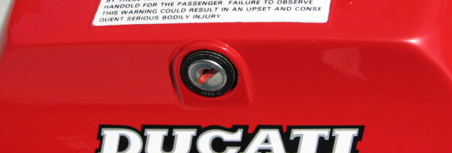

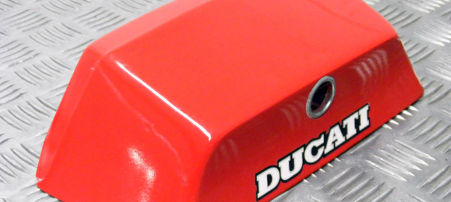

Not sure sure if one tail piece was used only on the P750 and 906 or only on the early ones and the other only on the 907IEs but there were two types.

My 907 is the same as the 2nd one, in the bottom picture. The black bezel is part of the lock assembly with nothing attached to the tail piece.

Yes their was two types, the 750 had the chrome bezel and my 906's and 907's had the built up area around the key lock. I think that they will all interchange but haven't tried it. Arch.

The top one is the same as fitted to my P750 with a long push rod that goes from the lock into the back of the seat to lock it in place :lol: :shock: The lock fixing and lock mouldings are different so don’t know if they’re interchangeable
