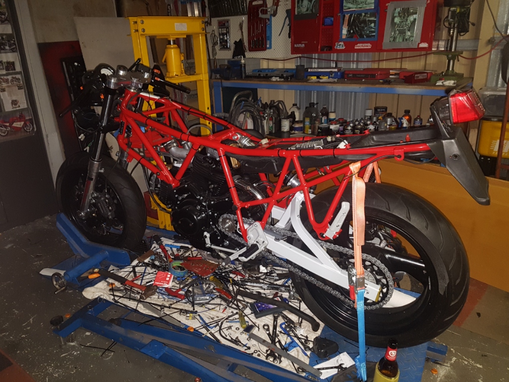

Just fitted the revamp dash and gauges , ordered some much needed stuff from s/d germ any, gone from no work to 7 days a week till December .

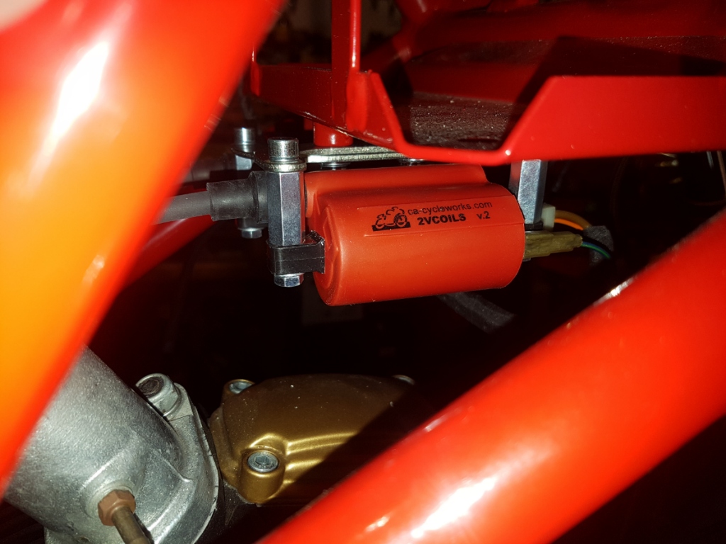

New coils are in and waiting on a lot of stuff from o/s to button up the mechanical side of things

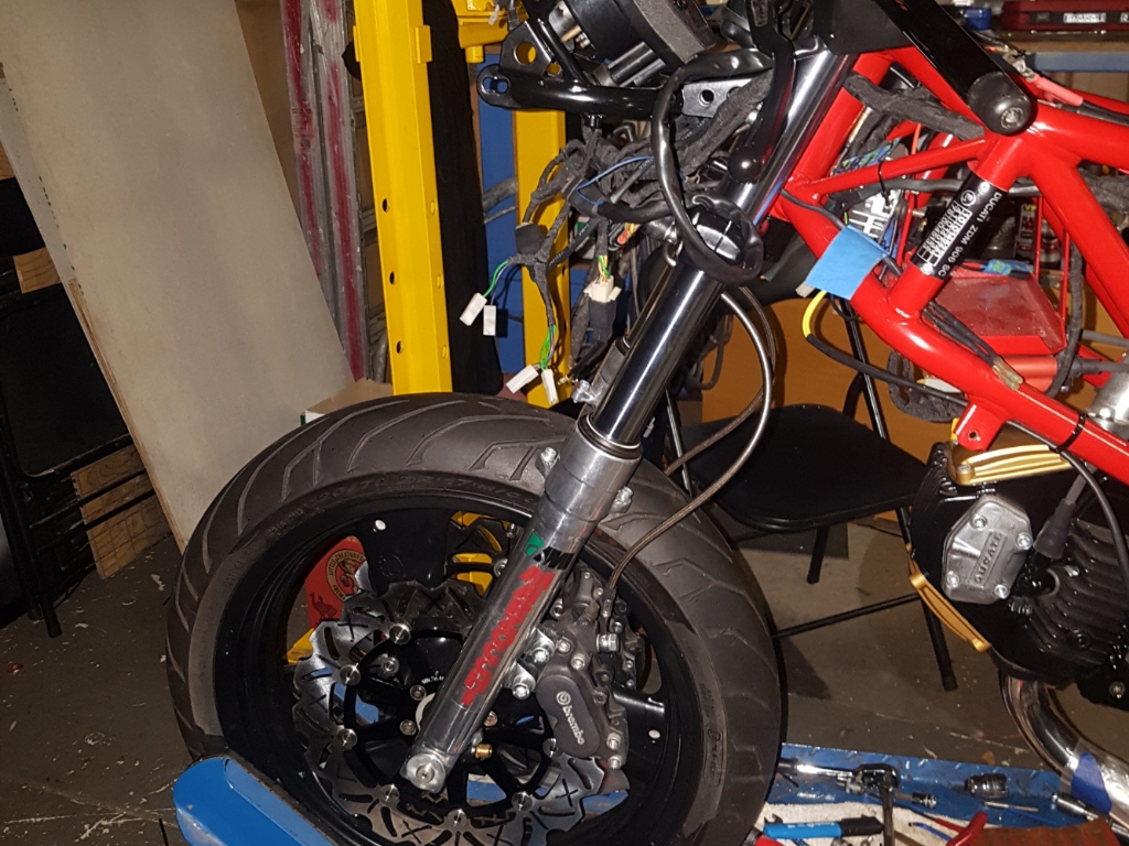

Recently got my new s/ hand lights and go switches and still waiting for lots of bits from s/d Germany , some parts on backorder and don't want the double postage, and the fork bling not politically correct but same as a Mk 3 lemans I had with the 38 mm marzochis and polished aluminum legs
