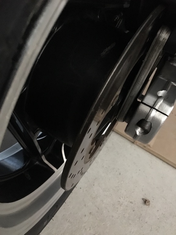

I had the tires changed a few weeks ago and I just noticed that the brake disk is rubbing on the pads - makes quite a bit of noise
which wasn't there before.
Since I have zero confidence in the shop that changed the tires considering they lost the front wheel washer etc,
can you guys tell me if this is normal / acceptable?
https://www.youtube.com/watch?v=w2CIPDwAqSM&t=8s
There are also some scrapes on the edge of the disk.
paso brake disk.jpg (84.82 KiB) Viewed 85773 times

NO , that ain't right. Is there any free play in the brake pedal or is it feeling solid, either the master cyl is not releasing the brake properly after use or the shop has put a spacer in the wrong place . I wouldn't ride it as I can see the brake over heating , and possibly locking without warning

Mc tool wrote:NO , that ain't right. Is there any free play in the brake pedal or is it feeling solid, either the master cyl is not releasing the brake properly after use or the shop has put a spacer in the wrong place . I wouldn't ride it as I can see the brake over heating , and possibly locking without warning
Alright, thanks. Brake seems fine. I think it's the latter.
What's your opinion of the scrape on the edge of the disk? Could it be rubbing there also?
I'll start pulling it apart today. Damn 'professionals'

Just undid the caliper bolts - they were super tight.
Hand tightened there's no weird rubbing. Moderately tightened there's just a hint of the noise.
Posts: 2019
Re: Brake disk rubbing
Ok , make sure the caliper bolts are not going so far thru the bracket , that the end is rubbing on the disc ,if so a washer under the head of the bolt. Get your head down at axle level behind the wheel and eyeball the disc ,it should be in the centre of the caliper, not off to one side. Some assemblies could have a steel washer between the caliper and the mounting bracket but I can't remember offhand if Paso does.

Mc tool wrote:Ok , make sure the caliper bolts are not going so far thru the bracket , that the end is rubbing on the disc ,if so a washer under the head of the bolt. Get your head down at axle level behind the wheel and eyeball the disc ,it should be in the centre of the caliper, not off to one side. Some assemblies could have a steel washer between the caliper and the mounting bracket but I can't remember offhand if Paso does.
Can anyone with a 750 confirm if there are washers between the caliper and the bracket?
The bolts are original and not going through the bracket.
I pulled the caliper and the pads, cleaned everything and put it back. Pretty much the same thing. There's one spot where it's 'resonating'
Strangely i can make it go away if I loosen the bolts on the end of the right side fork.
I remember that idiot mechanic had tightened the end of the fork before the spindle on that side,
which caused the tire to touch the fork, when he turned the wheel by hand. Not sure if that has anything to do with this, but dumb asz.
I did have it up to 140 km/h when I came back because a storm was starting.
Guess I'll have to pull the entire wheel and remount it to make sure everything's right.

The next thing to check is that the eccentric adjusters are both correctly positioned on the axle. They are splined onto the axle and there is one spline missing so they only fit one way , but with a little misguided persistence they can be made to fit wrong and the result is an axle that is skewiff in the swingarm. I get the feeling there is nothing "broken " , just been put back together wrong somewhere

Mc tool wrote:The next thing to check is that the eccentric adjusters are both correctly positioned on the axle. They are splined onto the axle and there is one spline missing so they only fit one way , but with a little misguided persistence they can be made to fit wrong and the result is an axle that is skewiff in the swingarm. I get the feeling there is nothing "broken " , just been put back together wrong somewhere
Yeah, I remember that - only the left side is like that, no?
I know he saw the missing spline and he was having some trouble but it looked like he got it right.

Get a hold of this - that idiot left all of the sprocket bolts totally loose - not even finger tight.
Total lunatic.
And to think, I took it to a Harley place because I was scared of the scooter place.
Anyway, I took the wheel off and remounted it - that resonating noise is gone.
Thanks for the help.
