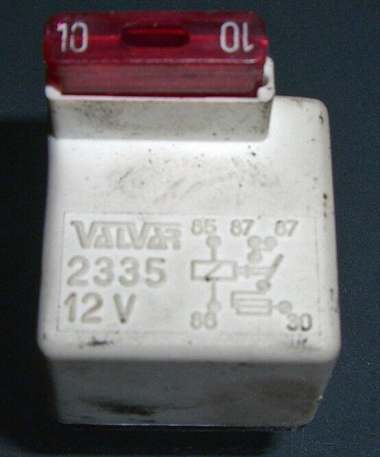

MP Italy 12V-2335 (installed i.e. in the Lancia Delta Integrale)
Valvar 2335

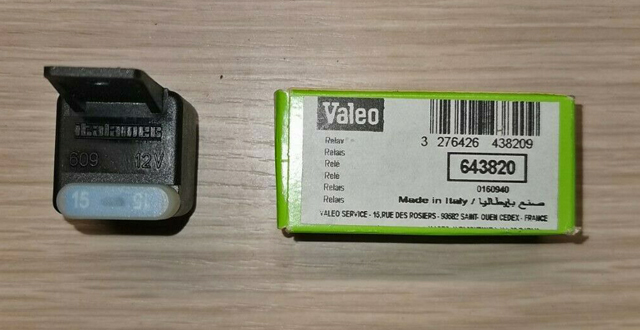

Italamec 218 / 609
Valeo 643820 (= Italamec)

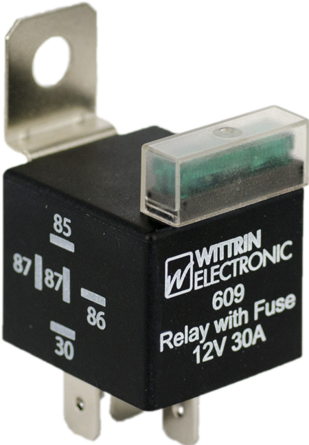

There's also a german company Wittrin Electronic Germany which makes a replacement. Just search 'wittrin electronic 609' on ebay. They sell them as a pair. (of course the fuse installed can be replaced with a smaller one)

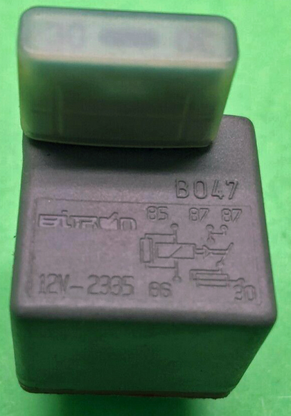

Then there's a BITRON B047 12V-2335 (see last pic) which can be found in some Alfa Romeos like the 156, 164 or 1990 Spider as relay for the a/c, cooling fan or hazard lights. It looks the same as the others but has a resistor between contacts 85 and 86. Where are the electronic experts who can say what difference this resistor makes and if this relay is suitable as a replacement as well?
