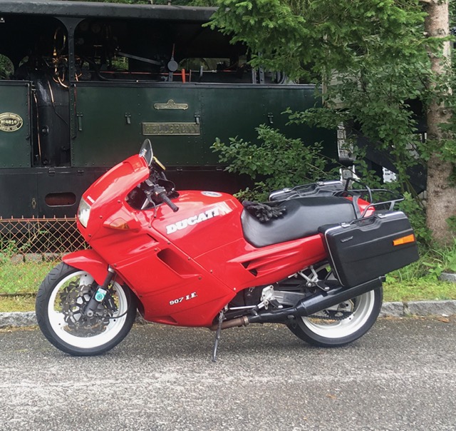

Hello! I own my 907 since almost 30 years now. Within the last years I made my experience with Monster 900 (1999) - Michelin Pilot, 851 (1991- don´t remember the tire) and 900 SS (1992) - Bridgestone BT-16 as well. What shall I say: they are all much faster and much more handy, although none of them (maybe except the 900 SS) can be really used for (2 person) travels. Searching this page for tire recommendations was not really successful, ok I will lower the forks and order 120/70 instead of 120/60, but my question is:
Which tire (Sport or Sport/Touring) is the choice of today for the 907?
I was quite happy with the Bridgestone BT21, it´s a long lasting, rain proof tire, but not really the choice for fast curvy roads.
I would like to try a more sport orientated 2 compound tire...
Any recommendations from your side?
