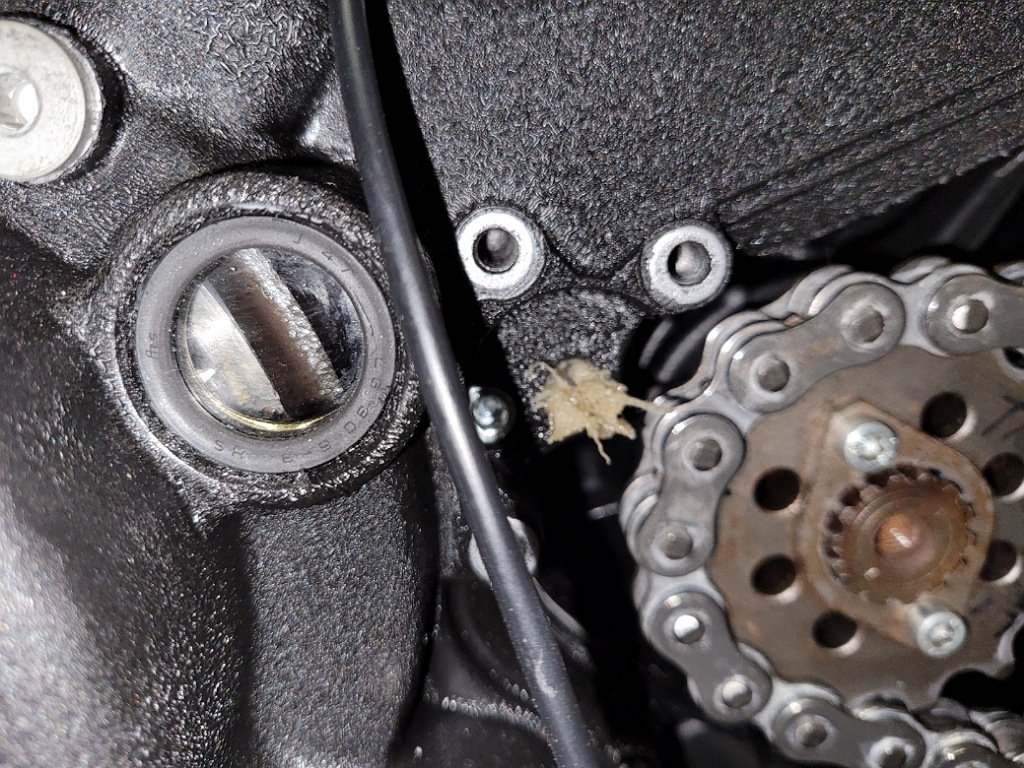

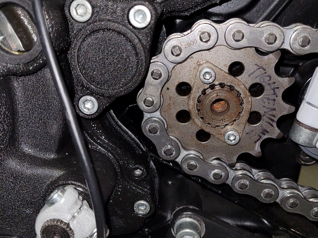

It's back on the lift to try and find what the clunking noise is that's coming from the front end.
Off with the fairing again.
That's when I noticed this on the lift.
So where's that coming from.
Not here.
I still don't like the way that's attached. Do you think there should be a locking tab that can be bent over the nut on there?.
It's looking like it's either the gear change shaft.
Or this cover.
I'll give her a wash while the fairing's off and keep an eye on it.

I'm starting to wonder if it's the floating discs now. It doesn't sound like a rattle though, more a clunk. The battery seems secure enough to not be moving. I'll see what tomorrows ride brings and report back. Hopefully it will show me where the oil leak is coming from as well.

Hi mate, I'm not sure if the 750 is the same as mine but a oil leak around that area could be from the clutch push rod thing , have a butchers at this pic, mine is from a previous post, the bit of of rag bashed in there is just so I can start up to show off to a mate at this stage, but an easy fix, bikes looking fantastic and it sounds like everything is working out pretty good.

Cheers. It seems to be a different set up to yours but I'll have a look.
