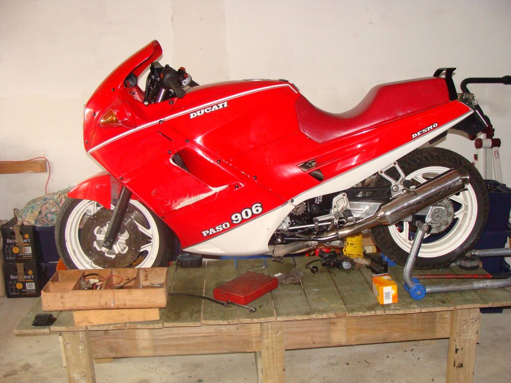

Sounds good . I found with my 906 that even removing the air box cover made it spit and fart and backfire . I guess you could "jet " your way around that if you wanted that intake howl , and lets face it , thats something no petrol head should ever grow out of :D . Fortunately mine has a pair of stainless mufflers ( not ) that you could drop a golf ball thru so noise aint a problem
, specially when I had voltage issues and it would backfire in time with the blinkers......big blue flames too ........ha ha , caused no small amount of panic when it decided to play up at an intersection outside a bank in Christchurch while I was waiting for the lights to change
