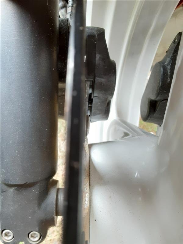

Great thanks for your help. Yes, I've been riding the bike without any vibration or something strange. But the front brake disk is not center of the brake caliper.

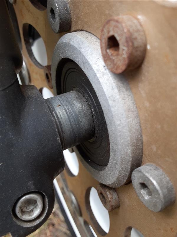

Yes please find the two pictures. First picture is showing that inner pistons pushing outward more than outer ones. And second picture is showing that the stepped face of axle shaft touching bearing directly, there is no spacer in between. I think the missing spacer few mm makes fork inward and unable to keep brake center. I hope you can see the pictures.

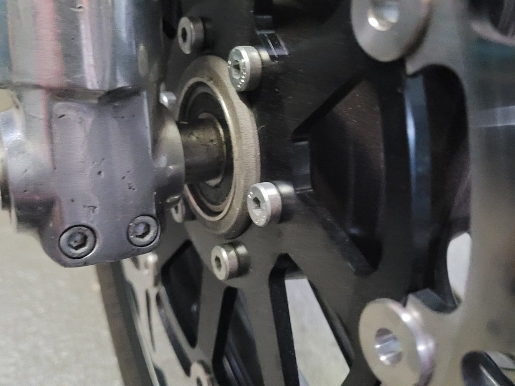

Hi Fuhe, I took this pic of mine, kooks same I think everything is ok

Yes, it looks the same. Now I understand that my bike has no problem.
