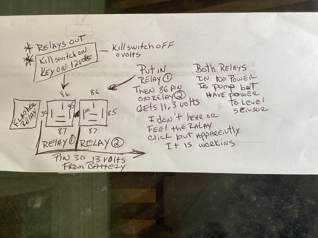

Todays findings. Not sure where pin 85 gets ground from to pull in the contact . That’s what is not happening.

Re: Electrical help please.
Fuel Pump is grounded through the ECU. If you are lucky you can repair the ecu. otherwise you'll need a replacement.

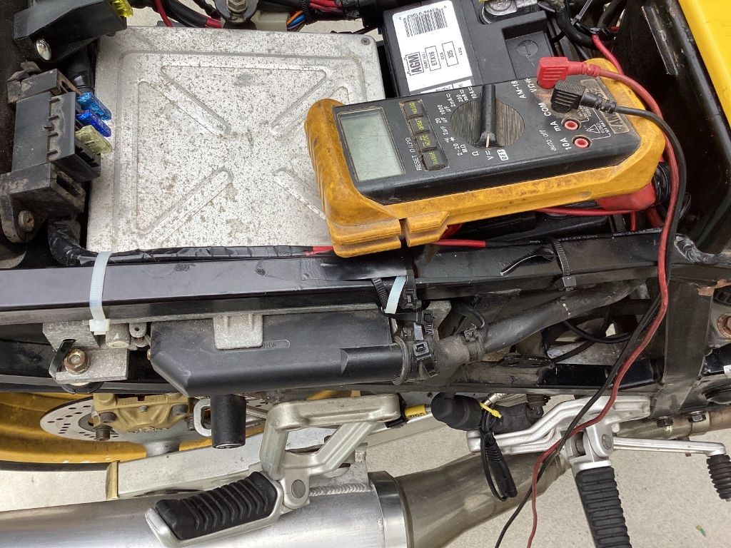

On all the Paso's it is wise to check every connection before replacing parts
As I was reading your posts I was about to suggest looking at the plug into ECU. Happened to me years ago. The bike just quit. I did the same as you, started checking everything and just so happened I was working on something and saw the plug hanging out. Push back in and all worked. I too used a zip tie to hold the plug in just like you did. There is one other plug that can do the same thing. It's a white plug on the left side tied to the frame rail with another plug at just about the back of the tank. If it comes unplugged the bike will not start.
