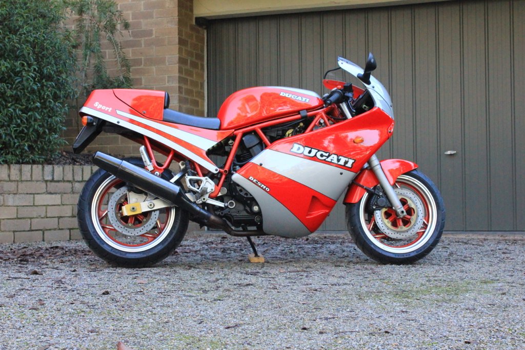

Hi All,
I've had my 750 parked up for a while and recently changed the oil and belts to start riding it again. Overall the bike runs great however the sprag is getting worse. With cold starts in particular I'm getting more and more sprag slip. Once warm, it starts without issue so I'm undecided whether to spend big $$ to fix it.
