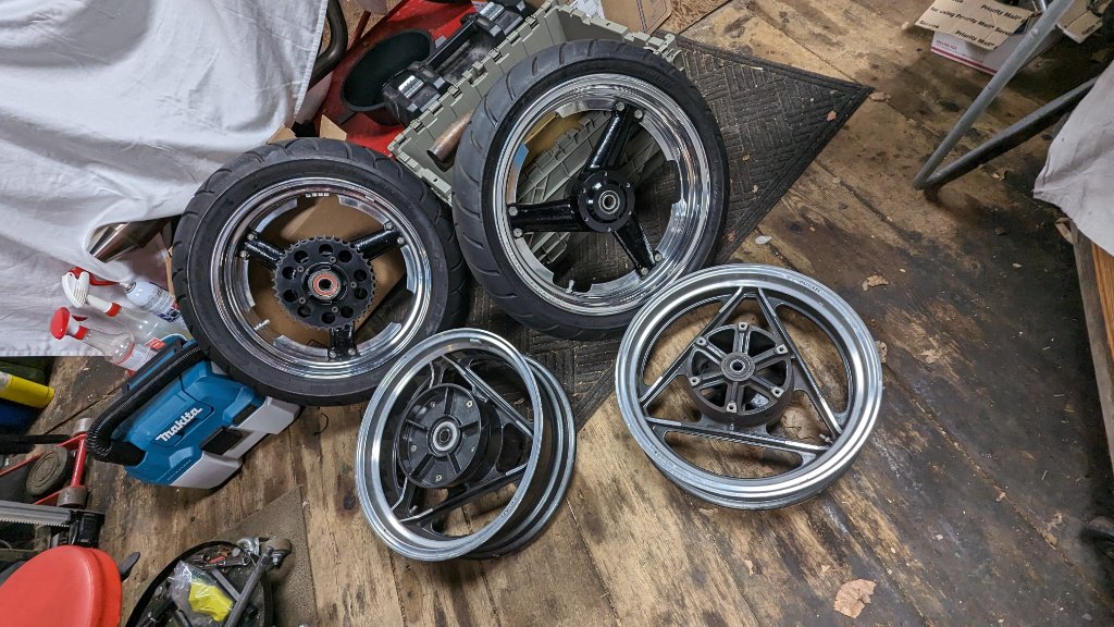

I found the wheels on a Japanese auction site for a very good price. The magnesium hubs and spokes had to be blasted and painted. Rims needed polishing. Replaced all the wheel bearings. Had to have the stock Rear center spacer modified to fit in the Marvic hub.

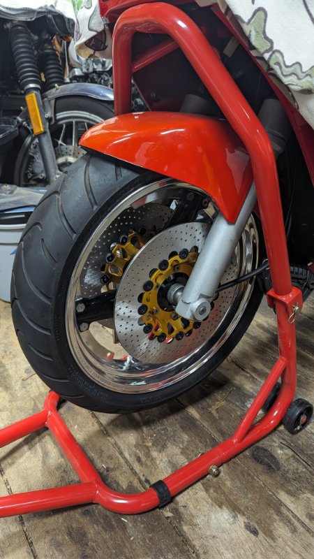

Paso EBC floating front discs are flat and the lightweight wheels need an offset F1 discs. Stein Dense had them. Rear disc is also specific and is NLA. Found a very rough one in Japan. Turns out a place in Australia makes them

At this point I have to sort the rear caliper hanger spacing and then have custom wheel spacers made.

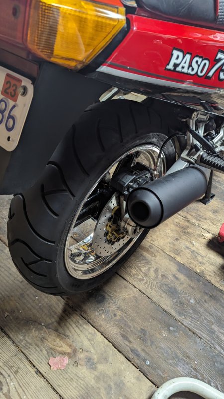

Using the temporary wheel spacers I managed to get the wheels centered and the rear caliper carrier properly spaced. Sunny and cold so I did a quick loop around the neighborhood and all seems to work as it should.
Steve at Bevel Heaven suggested getting small shims to fine tune the spacing. I ordered .5/1.5/2 mm shims and through mixing them I could get an exact measurement. I'll total up the sizes and then have permanent spacers made up.
As for weight...
Superlight front
4300g / 9lb 8oz
Stock front
6405g / 14lb 2oz
Difference
2105g / 4lb 10oz
Superlight rear
7150g / 15lb 12oz
Stock rear
9782g / 21lb 9oz
Difference
2632g / 5lb 13oz
The rear weights are measured with the cush drive but no sprocket or disc.
I need to get the polished section cleaned up and protected. They look great and hopefully they won't self destruct!
