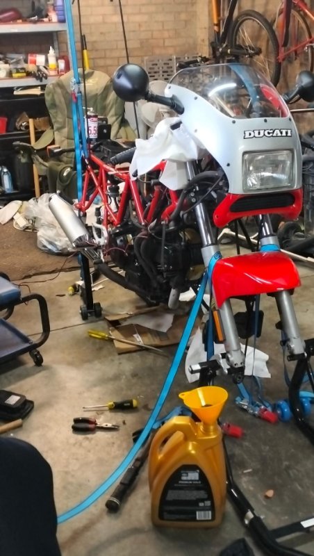

OK, heres a photo, just a polish up and shes good to go.....errrr not really. Pulling the bike down is fairly easy. I am a bit stressed when it comes to putting back together! I would like to be a mechanical type, but I'm not real flash! The brakes look pretty dirty, little rust. I will pull them down and put in fresh seals ( Brembo 08, 38mm seals, right?). Clean up the pistons ever so gently. Fuel lines, old but ot leaking. As I never got to ride it I dont know how the forks/rear will go. I'm going to polish up the rear axle, it is a bit rusty. Slow and steady.

Looks good . Give that axle a emery tape polish and a smear of some anti seize grease.
Take pix and put assemblies in plastic bags with the relevant fasteners .
I think its better to complete a task ( within reason ) before starting another , to many things on the go is not good for stress

Wow that looks pretty tidy! Not sure on the seal size but I have a packet out in the shed, will look tomorrow. Cheers for the pic post.

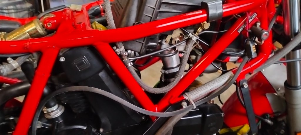

Been a while. Bit busy. Today the carb was finished off and air box/new filter put on. Rebled the brakes with a vacuum pump. Then, did the final touch the old fashioned way. I'm not convinced about the vac pump. The old way seems better. I had to clean out the fluid reservoir at the front. Brown sludge in it.seems ok now. Need a bit of advice on fuel line routing. In the pic the line goes from carb, dips down a bit the the tap line goes over the cylinder head and the return..just sits there! Slowly but surely

Yes that looks correct. The return goes straight up onto the bottom of the tank. My line does not have the pronounced dip and the main line runs straight through to the back of the tank with the return Teeing off it vertically. Six of one half doz of the other...
Your frame looks so good!
