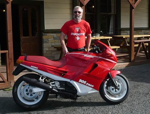

Today we rode the 906 two-up for the first time. In fact I hadn't been on a bike for a couple of weeks because I fell over and popped a couple of ribs out. No, I wasn't drunk! We rode with friends to a country pub about 60kms away. A good country road with plenty of fast bends and a few slow tight ones too. We had 35psi front & rear and the Paso handled beautifully. Very sure footed and giving me plenty of confidence to lean it over and crank it on through sweeping turns.
Here's a photo of me outside the pub. Multiple bike ownership prevents the purchase of a razor :lol:

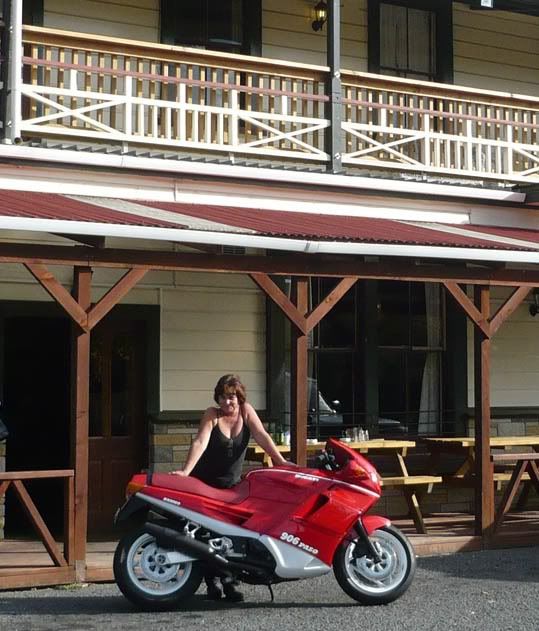

Francesco, Jenny asked me to take this photo for you :shock:
What is it about Italian men? :mad:
Perhaps, you told her I have got 2 Pasos :thumbup: :thumbup: :thumbup: :thumbup: :thumbup: :thumbup: :thumbup: ????????
Power of Pasos!
:lol: :lol: :lol: :lol: :lol: :lol: :lol: :lol: :lol: :lol: :lol: :lol: :lol: :lol: :lol: :lol: :lol: :lol:
Say hallo to Jenny.
Ciao :beer: :beer: :beer: :beer: :beer: :beer: :beer:

Frankie, You DIDNT told us what ALL You had in Your mind!!!(I know You...) :mrgreen: Pretty combination, Jenny and nice 906 Paso :thumbup: :thumbup: :thumbup:
