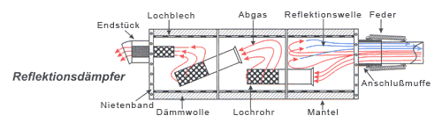

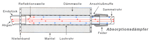

All carbon pipes don`t like excessive heat. That`s why about all carbon cans are absorbtion silencers.the problem with some of the all carbon ones on big twins is they get blown apart over time which is not so good.
Reflection silencers as most originals are heat up more as they are more restrictive.

Regarding absorption type silencers I think most new to the market - aftermarket cans for the UK are absoprption type as it makes the core very easy to remove for More noise or more performance for the Gixxer brigade and can be replaced easily at MOT time
I would imagine doing that in Germany probably results in a not very nice telling off and a failure of the TUV test
Like that digram by the way

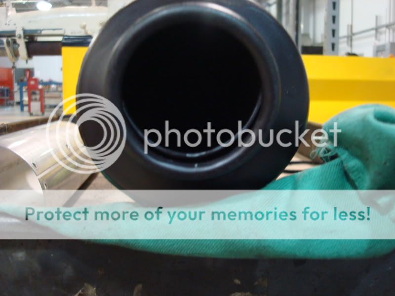

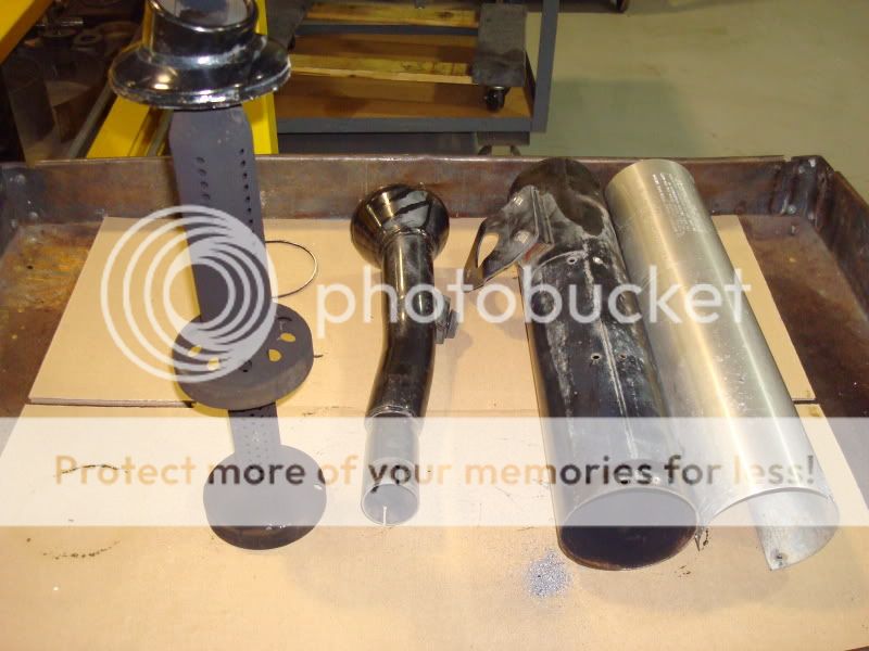

I did a similar mod to mine. removed the baffle put in a larger end pipe then machined out the outlet cap to match the larger pipe and rivitted the whole thing back together. I am very pleased with the somewhat deeper and slightly louder with out being raucous note

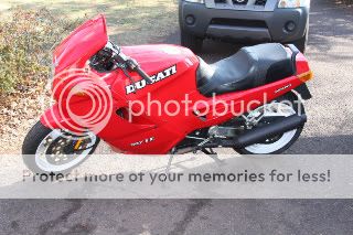

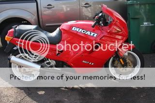

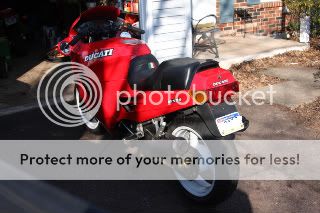

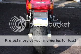

Higgy - I'd love to see a picture of those pipes on the bike
Rhino
If God rides a Harley . . .
Then the Devil rides a Duke!
- Posts: 3377
Re: Decent Exhaust Pipes?
I have as yet not had the time to finish the project,can't decide if I like it better in solid black or with the aluminium cover or maybe do something in some flavor de stainless
I plan to do a backpressure study in the near term but overall with just one side done it runs much better. I don't know what chip I have in it and the airbox is modified with a K&N filter
BTW, the diffuser went back in and is held by a single rivot so that I may remove it easily should I decide to modify it a little more as time goes by.
