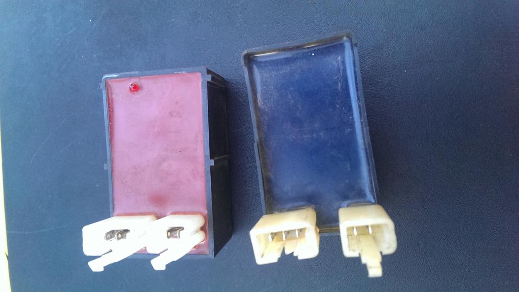

mostly wondering because my bike has two different modules. and at low rpms the front bank will occasionally miss fire and cause it to backfire through the intake... are the pick ups adjustable or servicable? i looked through the faq page but was unable to find much on the pic ups.
Re: new Paso owner
two different modules ? Do you have a picture ?

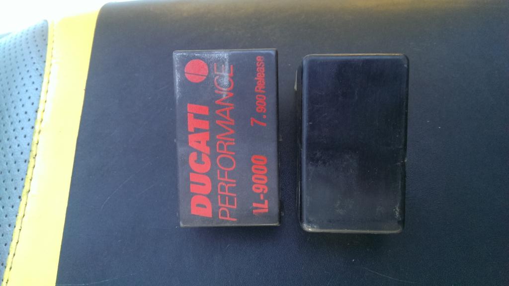

i can post one tomorrow..
yeah one says ducati performance and the other is just a plain looking balck box.. the duc perf one has an led and fancy red letters
Re: new Paso owner

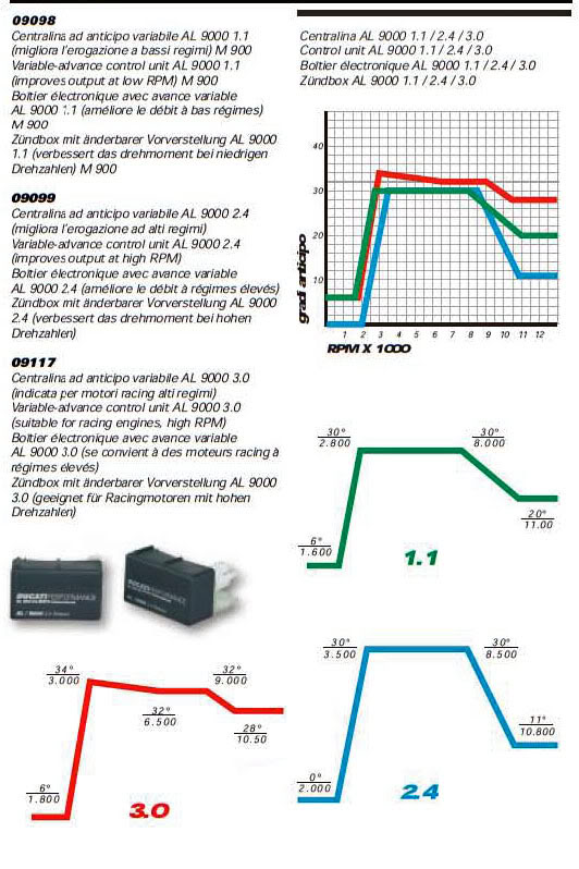

The Ducati Performance CDI unit (formerly from Pederzini) has a different ignition advance curve.

I guess that would explain the low rpm stumbling
Re: new Paso owner
the black one is the original Kokusan Denki BB1105
