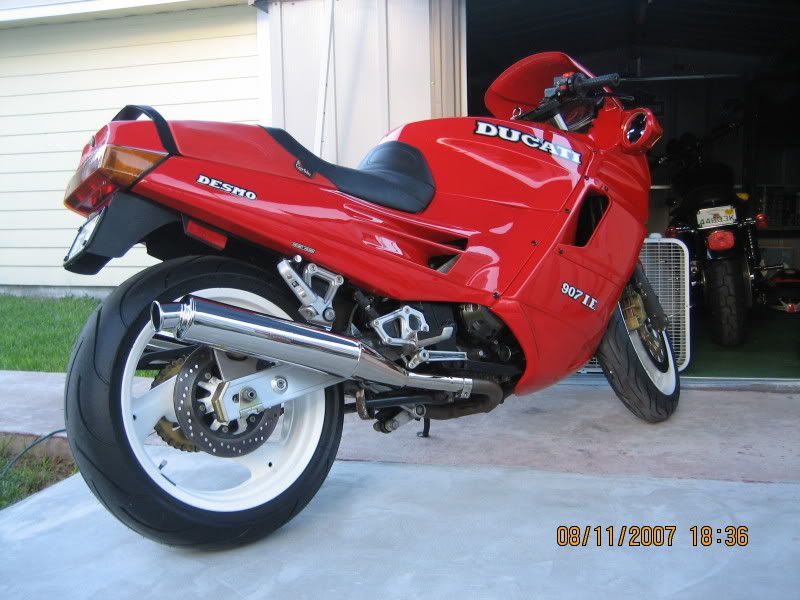

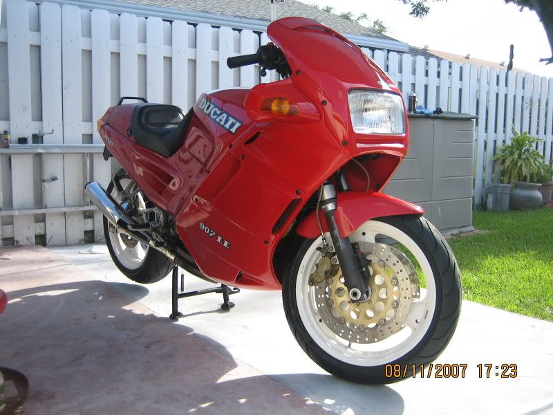

IT'S DONE!! THE BIKE IS FINISHED!!
Couldn't be happier, found a excellent local indy who did all the work; valves shimmed, belts replaced, FI & computer checked and tuned, fork, shock, brake, clutch and coolant systems serviced, new braided lines(all), new EBC sinthered front and rear brake pads, new clutch lower cylinder, new clutch springs and bolts, plugs, fuel filter, in tank fuel hose replaced, new starter solenoid replaced. Two new Michelin Pilot mounted & balanced (120 front / 180 rear)
All this for $822.00!!!
Plus he picked up and delivered the bike to my house, I mean it can't possibly get any better.
If anyone is in the South Florida area and you need a guy for your bikes I definitively recommend him 110%.
Otalora Racing - Willie @ (305) 971-4721 or (305) 342-5068
just tell him the guys with the 907 and the 900SS sent 'ya.
Nice, clean shop and a very responsible, courteous, professional guy.
Needless to say from now on he works on all mine and my brother's bikes ....
Laterzzz...
