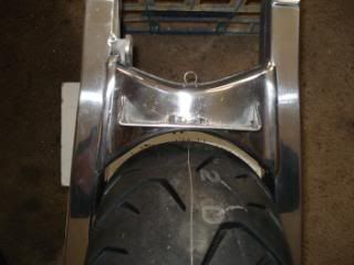

Just thought I let you know how I'm getting on with this.Thanks for all the advice.
Then I pulled the swingarm out and and modified the back of the cross member,I cut through the welds in the center and on either side and pressed it in.It now has about 12mm clearance between the tyre and swingarm,will have to wait and see if that is enough.

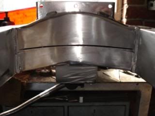

This is after I welded it back together.I had to press the arms apart because they pulled in 4mm from the welding.

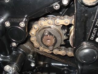

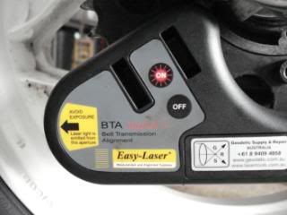

I borrowed the lazer liner from work and set it up on the sprockets and found that the front sprocket needed altering as well.To fix this I turned the sprocket around.jcslocum wrote:You need to be mindful of the chain running in a straight and true alignment with the 2 sprockets. Running them offset will give you problems.

how did you do that?... and pressed it in
Re: How much is enough
I used a combination of a hydraulic press,large hammer & copper dolly.how did you do that?... and pressed it in
did you fix the rear end of the swingarm with a large spacer while doing that ? I would be afraid that the swingarm ends would move inwards when applying pressure to the middle section.
I did have a block of wood jammed in between the arms to stop them from pulling in when I welded it.They still pulled in by 3.5mm but it didn't take much effort to push them back out with a hydraulic jack.paso750 wrote:did you fix the rear end of the swingarm with a large spacer while doing that ? I would be afraid that the swingarm ends would move inwards when applying pressure to the middle section.
