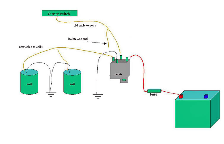

Where would I locate this? Is it difficult?paso750 wrote:the wiring mod for the coils
Are the coils an easy-replace? The wiring to the starter appears pretty heavy duty as it is, and the bike cranks like fury with the new starter. (That's good, right?)paso750 wrote:stronger coils (like Dynas) and a proper (thicker & better) wiring for the starter and grounds.

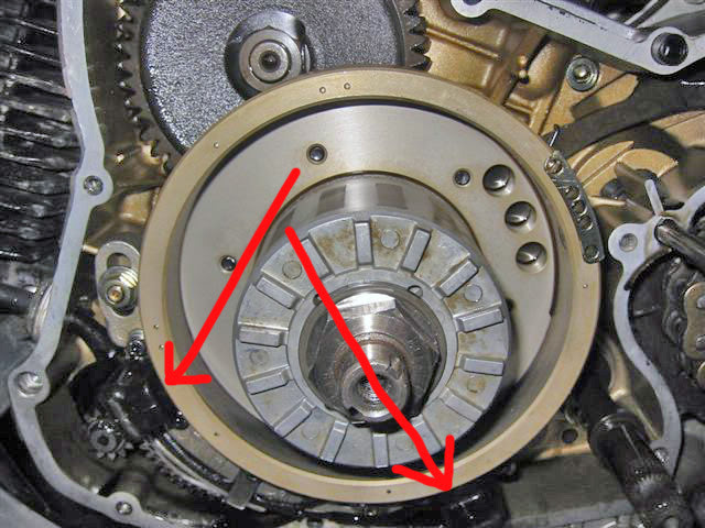

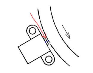

What is this clearance pick-up to the flywheel you speak of?paso750 wrote:The first three will improve the starting the last the cranking. (the first two are a must) If all this won`t help you should definitely check the clearance pick-ups to flywheel.

It`s easy, just remove the orange wire that goes to both coils, isolate one end and connect the second to a relay. Then run a wire (1,5mm² will be absolutely sufficiant) with a fuse in it from the battery to the relay. Then the relay needs a ground connection and an Y-wire that runs to the coils. That`s it. The relay will be activated by the starter button and the coils will get the full battery voltage w/o any voltage loss. Looks like thisWhere would I locate this? Is it difficult?
It`s possible that you`ll need to make a new mounting bracket, not sure about that (would need to check). The wires at Dyna coils are connected with ring connectors, not spade connectors like the original ones. With aftermarket coils you`ll also need new spark plug wires. All in all I`d say it`s easy.Are the coils an easy-replace?
Yes, it is. There was a long discussion on the P750 forum about this. Larger wires reduce the voltage loss. IMHO the size in this case is not really the issue, but the quality of the original wires and connectors is. They degrade, creating higher resistance, voltage loss and heat. If the starter cranks fast and freely you`ll be ok with your old wiring. Still you may think about changing it in future.The wiring to the starter appears pretty heavy duty as it is, and the bike cranks like fury with the new starter. (That's good, right?)
Simply said at a certain flywheel position the pick-ups send a pulse to the CDI unit which then controls when to fire the spark. The pick-up signal/output should be 0,5-0,6V when cranking, 1,6-1,9V at idle. As pick-ups and flywheel don`t touch the distance between them is important. The manual states 0,9+/-0,15mm. Good is 0,7-0,8mm for street use and 1,0-1,5mm for race use. If there are starting issues with cold engine one can reduce the clearance by 0,2-0,3mm. (if the issues are in the high revv range one can enlarge the gap by 0,2-0,3mm).What is this clearance pick-up to the flywheel you speak of?
