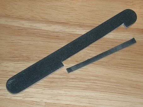

Thanks to this thread, I learned of a problem before it became one with my project Paso. While having the Dellortos apart, I noticed these dimples in the slides, and with this thread, I knew I should file them out. I didn't have a file that size, and wanted to share with you what I found to work.
I ended up using one of my wife's fingernail files! :laugh: I measured the width of the gap in the slide, marked the nail file, and cut it to the width that I needed with a utility knife. This type of file has a course side and a fine side, so it did the job quite nicely. Just make sure that the file is fairly stiff, so it is easier to keep crisp lines and angles when filing. I hope this helps.
