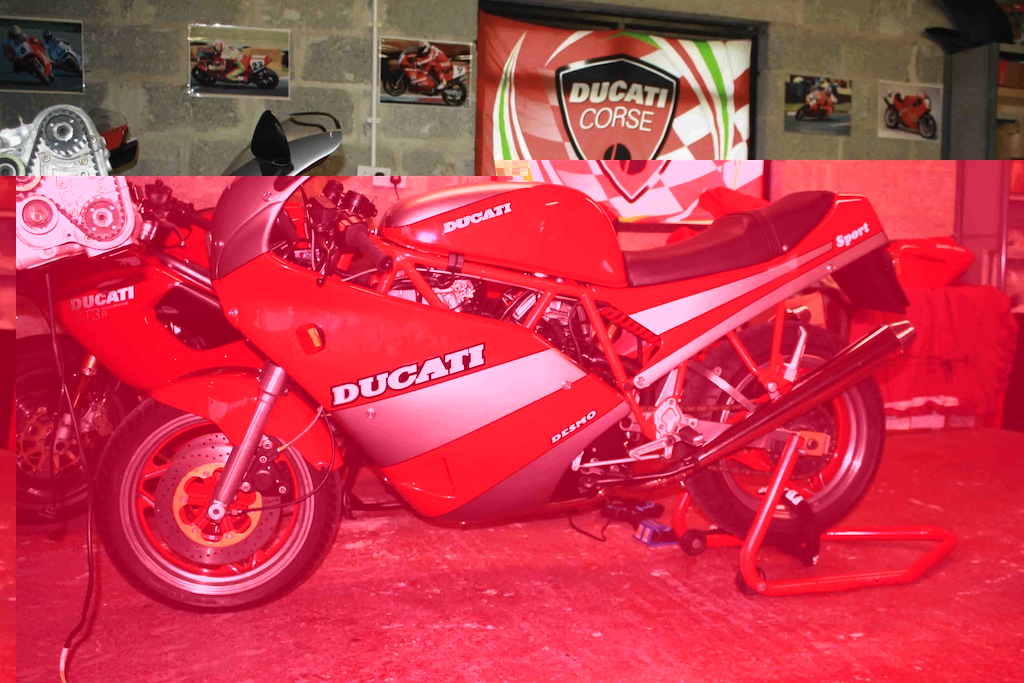

I doubt works well is those double bent intake tubes
Look just fine to me,plenty large enough in diameter to not be an issue,remember there is a bar of pressure filling them up constantly :thumbup:
If you look at current trends in ram air induction on higher end bikes the tubing is very small multi channel affairs. Also in the auto world with variable intake designs the channels are a lot smaller than the average person would think is needed. It is pretty ingenious the way some of the design accomplish an almost tripling of the tuned length with such a small volume of space required. jm2c :beer:

Love the exhaust. Looks really good on the Sport.
The intakes look just fine as long as they are larger than your throat. Indeed, they contain the fuel fog at low speeds making the bike much nicer to ride around town. I use 90 degree rubber elbows that are 50mm ID. The first bend in your system is certainly needed to get the filters to clear, but the second bend is debatable.
One part missing, or actually two, the rubber blocks between the frame and the tank. Same as old Bevelheads. You can get them from Bevel Heaven. Without them the back mounting tab on the tank flexes too much and will crack. I put two on each side just for good measure.
Great job overall.

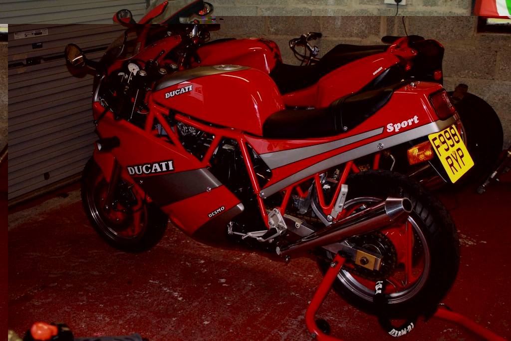

Well finally got the Sport finished and on the road, few niggles held things up (and working on other bikes!) ;
- getting carbs sorted and jetted, have ended up with 132.5 mains (140 too rich), and dynojet needles, perhaps a bit lean but moving needle jet position should sort it.
- forks were terrible - like a set a pogo sticks at the front, no damping at all! I stripped and rebuild them - nothing wrong, Ohlins agent did the same - still terrible, looks like the problem is with the bypass 'valve' on the forks - just does not work. Maxton will fit a set of modern cartridges to them - but cost is over £600 ! Ended up fitting a set of Hagon progressive springs and more reducing the air gap which makes for far stiffer front end (interestingly the Hagon (Wilber) springs are too long to fit with std preload spacer and too short without - ended up using a 40mm preload spacer in them - Hagon were no help and asked that I tell them what sized spacer I used!!)
On the road the wee bike handles pretty well - esp since fitted a nice set of Verlicchi competition clip-ons.

Always a few niggles to sort out. I don't think it ever really ends. But as long as you get a crowd around your bike at the next meet, you know you did good, and you surely should get an audience for that beauty. Nicely done. Lovely pipes.
