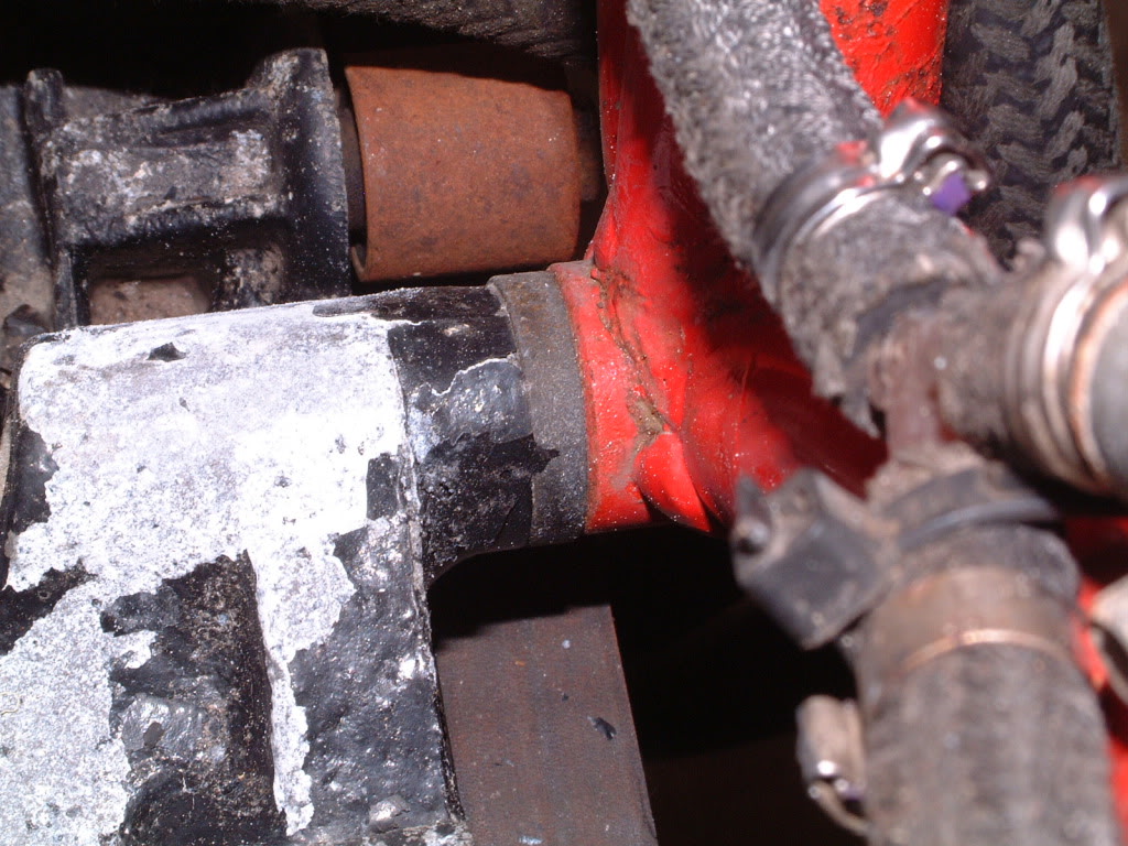

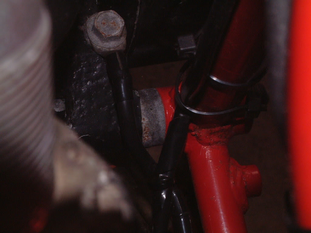

Are these the spacers.
Front right.
Rear right.
I also have one on the rear left.
My compliance plate says 12/1988.
A2

Ok, I need to do some measurements to get to the bottom of this spacer thing. I hadn't seen the one on the back left of the engine before.
Also, the spacers look small to me. I'm wondering how many versions of the frame they made now.
I'll measure my spacers to see what I have. Mine is a California issue 1989.
As G. pointed out, with all that corroded aluminum, you will need to spend a considerable amount of time on the electrical connections.
