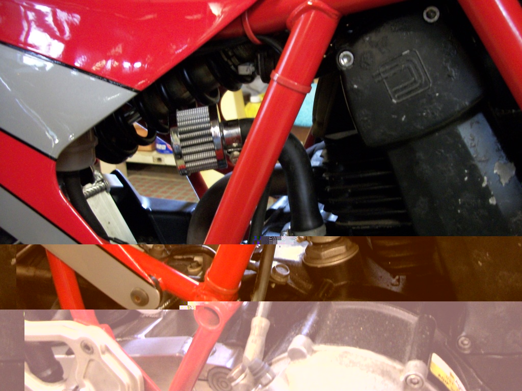

Oh and finally did this
And this time it won't try killing me by spitting off the countershaft sprocket when I road test it, now that certainly redefined the meaning of road test.

Hopefully a big day today, if the weather holds, (been pooring rain here for days) it's now road legal and has rejoined the ranks of the living, so going to take her up the mountain for a spin, mind you have the trailer hooked up to the car ready for just in case......................
- 100_3484.JPG (349.31 KiB) Viewed 8096 times
- 100_3482.JPG (218.48 KiB) Viewed 8096 times
