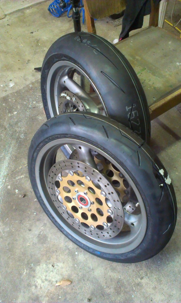

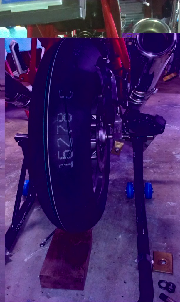

Finally got the wheels back, tyres look suspiciously like grooved slicks, so now all the fidderly bits start, like getting them to actually fit, Dave Ward at Moto Italia is being extremely helpful which is great, just have to get a rear brake caliper carrier off a monster or mid 90's SS and the back is done, chain lines up perfectly, so about a week or so I hope, Moto Italia will be machining up the various bits to get the front to fit.
Went with Phil's advice and got a 120/70 for the front.
Where is yours up to, or is that a verboten subject at the moment?
Peter

Probly need an SS caliper too .... the hole spacings are different by 3-4mm ( I just eyeballed mine ) the SS calipers holes being closer together. I can do a proper measure up ( with pix ) if you want :)

I forgot to tell you, but you now know, or just got lucky. The sprocket carrier that comes with the 4.5" wheel aligns the sprocket perfectly for the Sport. The sprocket carrier for the 5.5" wheel puts the chain a bit more outboard.
You are going to love those new wheels, and brakes. Its going to be a new bike. So much more forgiving, and easy to ride. You are now free to change your line in the middle of the corner if you need.

ducinthebay wrote:I forgot to tell you, but you now know, or just got lucky. The sprocket carrier that comes with the 4.5" wheel aligns the sprocket perfectly for the Sport. The sprocket carrier for the 5.5" wheel puts the chain a bit more outboard. Cheers, Phil
Did read about it in your post about the conversion before I started, and it didn't sink in, so this lining up was pure arse, and if hadn't bought the Monster axle with all the sleeves and spacers on it when I got the wheel, well, they'd be be some very fruity laguange being used in my shed indeed
Mc tool wrote:Probly need an SS caliper too .... the hole spacings are different by 3-4mm ( I just eyeballed mine ) the SS calipers holes being closer together. I can do a proper measure up ( with pix ) if you want :)
Bugger, always knew the carrier wouldn't fit, but didn't want to get the SS or whatever, til I could actually see what the gap would be (17mm), then thought I'd get away with reusing the original caliper :,(
I've obviously got mine off a the moment, so will take it down to the wreckers with me to compare, thanks for the offer though :thumbup: .
Peter

I think all of those more modern rear brake calipers have the same bolt pattern and fit the same rotor. One of the fiddly bits to work out is the brake lines. You did get an upgraded master cylinder for the front also?
bmw851
Posts: 322
model: other
Re: Being nasty to my 750 Sport
Post by bmw851 »
G'Day Phil,
Grabbed a Nissin Master Cyclinder off a Honda 1100 Blackbird (the purist will be up in arms) when I was picking up the wheels the other week, it's already bled and fitted.
So off to the wreckers yet again tomorrow for the carrier, it's the only advantage of working as a casual, can do most of this stuff during a normal working week.
Peter
