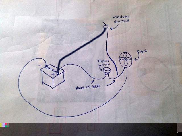

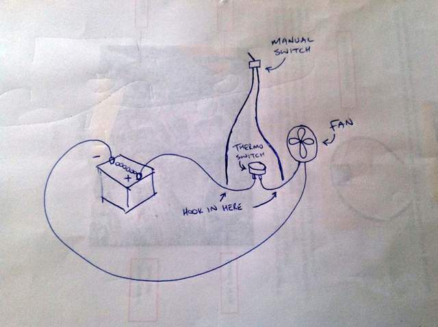

Now how is that ? If you forward 12V from a manual switch directly to the fan how will it keep it from working ? Ok, in Warwicks drawing nothing would happen as the fan is missing it`s ground connection.putting a switch in one side or the other of the fan switch circuit will not turn the fan on, it will just keep the fan switch from working.

Hey Warwick, I've just done the same on mine.
All you have to do is hook in to the wires that come out of the bottom of the thermo switch.
Lane

Re: wiring manual fan switch
Yes that is the best way to do it. You still leave the switch working and don't have to worry about blown fuses or burning out your fan when you have your switch powered and the fan switch closes. Also its is simpleHey Warwick, I've just done the same on mine.
and exactly what Warwick has drawnAlso its is simple
Warwick's drawing shows independent voltage to both the switch and his switch from the battery, not the same thing. if he turns on his switch and the fan switch closes his drawing will give 2 12v sources to the fan
I take his drawing as a schematic drawing, which it obviously is. Where you take the 12V from which you manually switch to the fan doesn´t matter. If you run one wire from a consumer load to a battery or two doesn`t make a difference. It`s the same 12V getting there. I can`t believe we`re discussing this.
two wires lowers the resistance, if the voltage is the same the amperage has to go up.If you run one wire from a consumer load to a battery or two doesn`t make a difference. It`s the same 12V getting there. I can`t believe we`re discussing this.
the only way to avoid it on Romus's drawing would be to use the same ground path and/
or the same supply path for both switch. EXACTLY the way Lane1feathers has drawn it.
granted the only time this would happen on his drawing would be when both switch activate at the same time
G if you take a toaster and add a parallel plug to the same terminals and plug them both in your toaster will blow up of you will pop the breaker, try it but not indoors please
so you`re saying that this will work and this not ?
I don`t know about your toaster but mine runs on AC and hence is a total different thing.
Try to to connect a 12V lamp to a battery and then add a second + wire w/ or w/o a switch in it, then tell us if it lights brighter, blows up and doesn`t light...
So at the moment I have the second picture setup, via a spare relay outlet. I can change it to pic one if needed. I'll keep watching the debate.
G as your drawing is both will work, not the best solution but it will work
