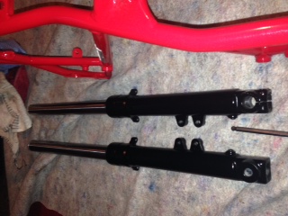

Forks with New Stanchions, Seals & Oil.jpg (38.7 KiB) Viewed 16602 times
Next up the Forks
Sliders blasted & painted
Stanchions were straight but just started to bubble ... soooo in with some new ones to go with Bushes, seals, etc
Easy enough job
