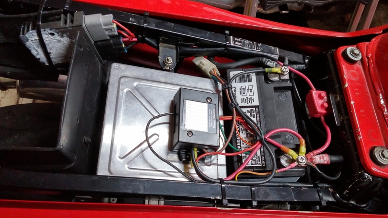

Not quite finished yet but is now charging properly with dual headlights on.
Still need to route a few more wires through the new fusebox to get them off the battery and decide where I want to put the regulator permanently but it works :thumbup:
Took the lithium out in favor of a glassmat while I am experimenting, lithium is kind of particular on charge rates

Was the connector issue one of the bullet terminals up by the steering forks? I'm struggling with an underperforming charging system, no charge at idle, about 13 V at 2500. All bullet connectors for the reg. seem to be OK.
