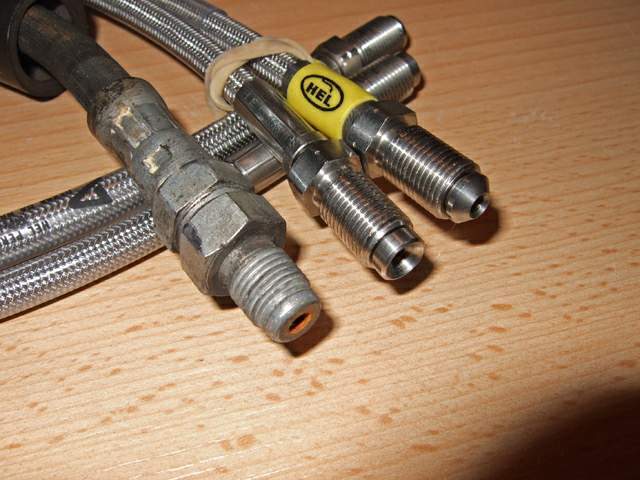

Giscard, it would be interesting to know if you really have the same end pieces on both sides of the brake lines.
My MQ brake lines (can`t remember where I got them as that was many years ago and they probably aren`t available anymore) have a short end piece on one end and a long one on the other (like the one on the last pic on the right)
This is the original Paso brake line next to a HEL for a 851 (which has a splitter, too). As far as I know usually brakes have either the left type end piece + a washer or the right type without one (on the caliper both types work). Not sure about the center concave end piece

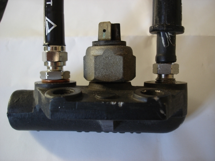

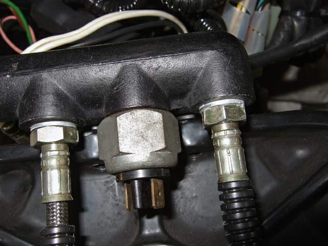

Paso 750 thanks for all of those pictures. The one showing the lines into the splitter are exactly how I envisaged mine looking.

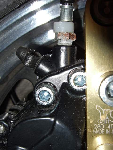

The centre one is for connecting directly to a hard pipe.Not sure about the center concave end piece
