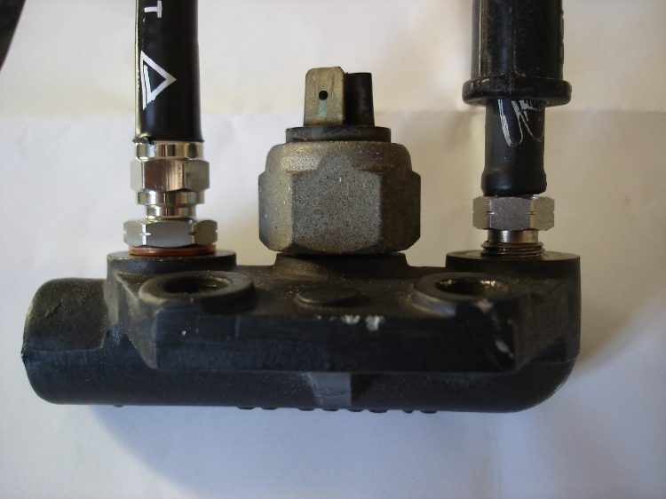

After being totally disappointed with the Cobra brakelines which rely on the line sealing inside the line splitter on some non existent flat face, I bought a set from Venhill. A bit more expensive but it works a treat and it does not leave a chunk of thread showing either at the line splitter or the caliper. It has the added bonus that there are no leaks. Good old copper washers.
I have tried to attach a picture showing the Venhill one on the left and the Cobra one on the right.
You pay your money and you get what you pay for. Personally I would advise anyone contemplating changing lines to avoid Cobra or Hel as the Cobra is apparently copied from the Hel one and Cobra kept insisting that there lines were fine and nobody else had complained. C'est la vie.

Do you have a picture of the inside of the splitter? The thread showing would be ok if the sealing surface in the splitter was conical and the bolt was too.
Re: Braided brake line problem
Posted: Mon May 25, 2015 11:23 am
by Giscard
Not one that you can see clearly. But you can imagine if it is drilled from one end for the line from the master cylinder there is a reaonable chance that when the holes for the lines to the caliper are drilled the mating face because of the master cylinder drilling is always going to be curved and that's what it looked like to me.
Posted: Sun May 31, 2015 11:33 am
by Giscard
Sorry to confuse Paso750. I mean the picture that I posted on May 25 above.
