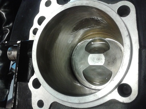

My paso is a cali model with a few changes like the 906 is equiped with. Probably telling you nothing new, but it has the digiplex with matching flywheel, pickup etc. Also it has different gearbox bushing, exhaust headers, heads slightly different etc. On top of my head the pistons have a CR of 9:1 see picture. I installed the stock Borgo. High Compression if you compare it with the cali pistons ;)
The jet setup is wierd, I admit. I have driven it for ten years with the 145 main jet and it run ok. No burned valves, brownish color on the plugs, some hesitation around 5k rpm. Couple of years ago I started to have a go at the Weber. First step was the setup of Jay according his topic "Weber what if". I even bought a LM-2 and installed a dung on the rear header. With the 145 main etc setup it run around stoich. Only still lean and rich spots at transition.
Tx for the links. Always fund of some literature ;) For calculation of the CR I would prefer a meter at some time now it has a dome on it..
