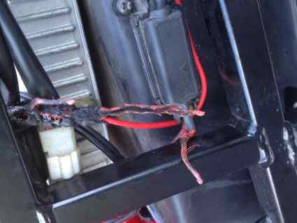

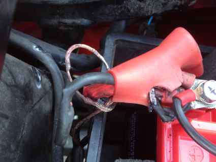

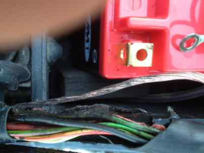

Went out today for my usual Sunday ride and after 5 miles the engine died and loads of smoke came from under the seat. When I looked under the seat a wire from the battery had melted all the insulation off it!
I called the recovery after disconnecting the battery to avoid further damage.
Luckily a lady in a house saw my plight and made me a coffee whilst I waited for the recovery vehicle,
Her husband used to ride motorcycles!
I will take some of the fairing off to see the extent of the damage to the loom

Took some photos of the burnt out wiring loom, it's mainly under the seat area.
I traced the fault to a wire shorting to the frame!
I have purchased a S/H wiring loom and will attempt to fit it soon!

You're lucky the whole bike didn't go on fire

Original Regulator ?
