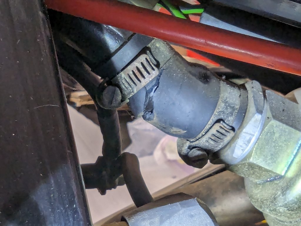

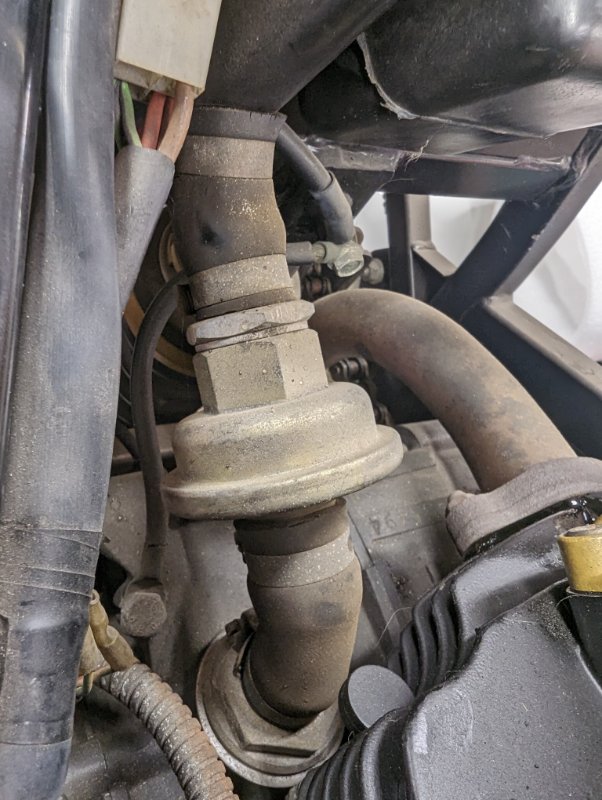

One of the many items to replace is the hose for this. Gonna be fun but all I have to do is really just find one straight section and another with a 45deg bend.
Might just get a new one of these because who knows if the inside has any issues.

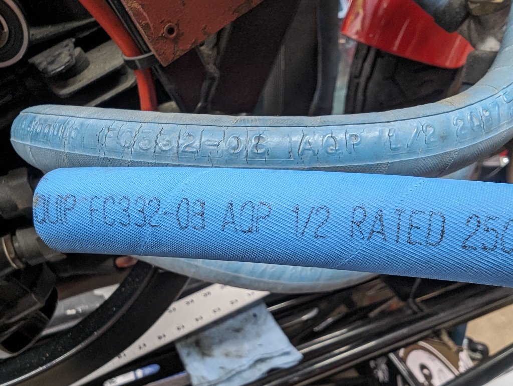

On Ebay I was able to score two 36" pieces of this hose to eventually replace the originals as the case is cracked on one. Right now, it's just get the bike going and verify it'll run before I tear into it and find I can't fix it. Looking into the barbed connectors for these hoses and well, that was a rabbit hole adventure!
I'll eventually get around to finding the smaller hose that connects the left and right coolers. Then I'll worry about learning how to connect them- probably find a spare set to practice on before removing the originals.

by enginerd

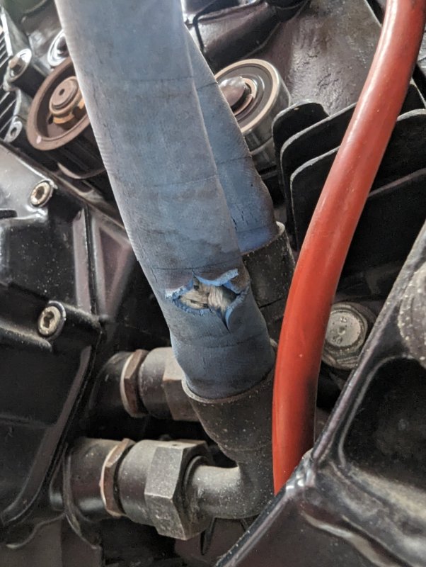

The worst crack/ tear in the casing to one of the cooler hoses.
Just when I thought I had the Y-pipe situation all figured out by finding the OEM part number part online out of Australia, it's too big. This is where I think all hoses were to be 8mm but as you can see from the OEM part on the left, I need a 7mm y-pipe to fit that stinking little return jet and hose back to the tank.

You can just lengthen the return line to provide resistance . Mine is smaller dia ....I think 3mmID and about 750mm long , cant remember for sure

Novel idea about changing the hose length and size for resistance. Might have to look into that one, thanks!

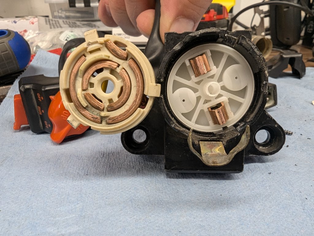

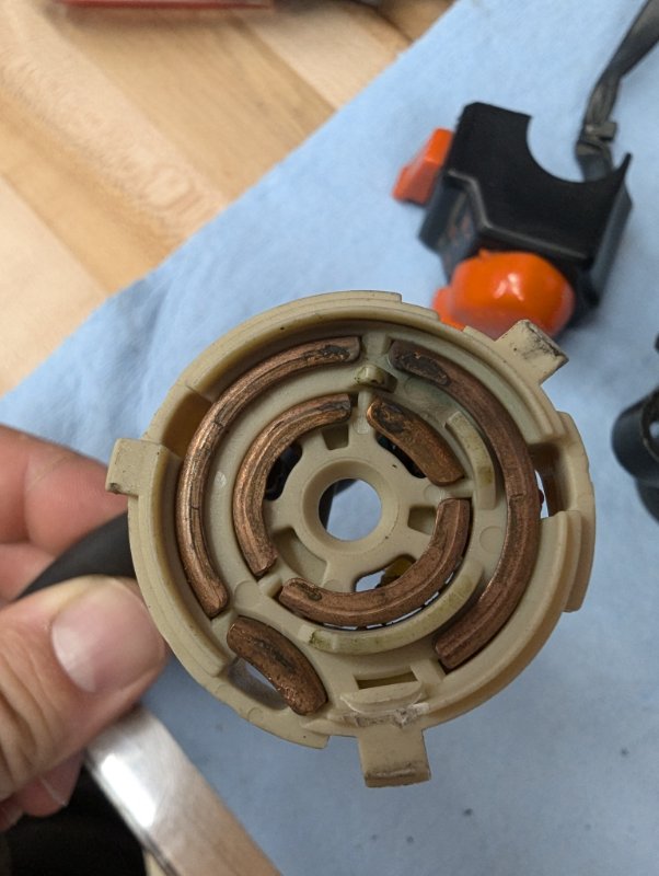

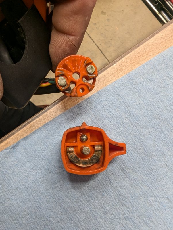

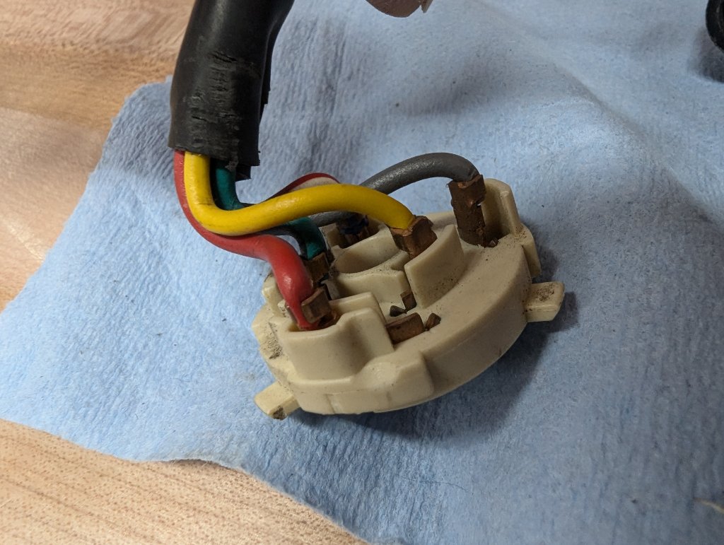

After figuring the timing belt out and getting that all situated such that I feel comfortable with it, it was time to turn it over. Stuck the key in the ignition and turned the power on and nadda.... no connection. Did a little bit of research on the forums here and found about the continuity issues and to properly take the ignition cylinder apart to clean it. Sure enough, mine was nasty. Used some scotch-brite and cleaned the contacts up.
Cleaned up nicely.
These don't look like fun to remove so I'm just going to leave them right there.
All nice and much cleaner to get some juice flowing through

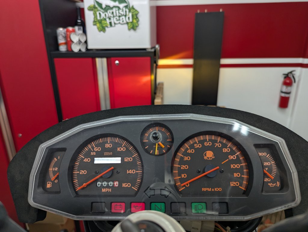

Hooray, I have power!!
Had to clean the contacts on the run switch to get it to consider cranking over
Because who doesn't love to sip on an espresso while tinkering on your bike?

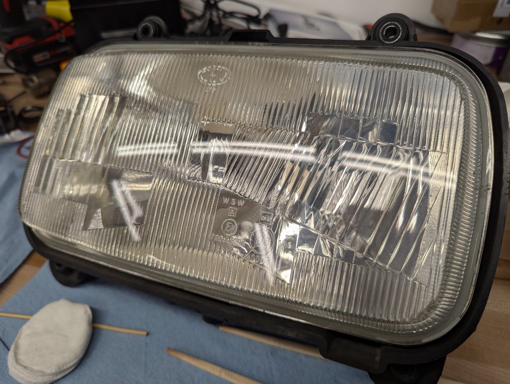

Little bit of a hazy light here, time to bust out the super extended cotton swabs and cotton wipes.

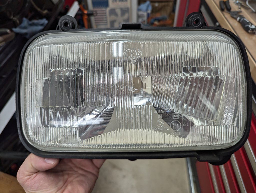

Much better!
This was quite the pain but it's much cleaner now.

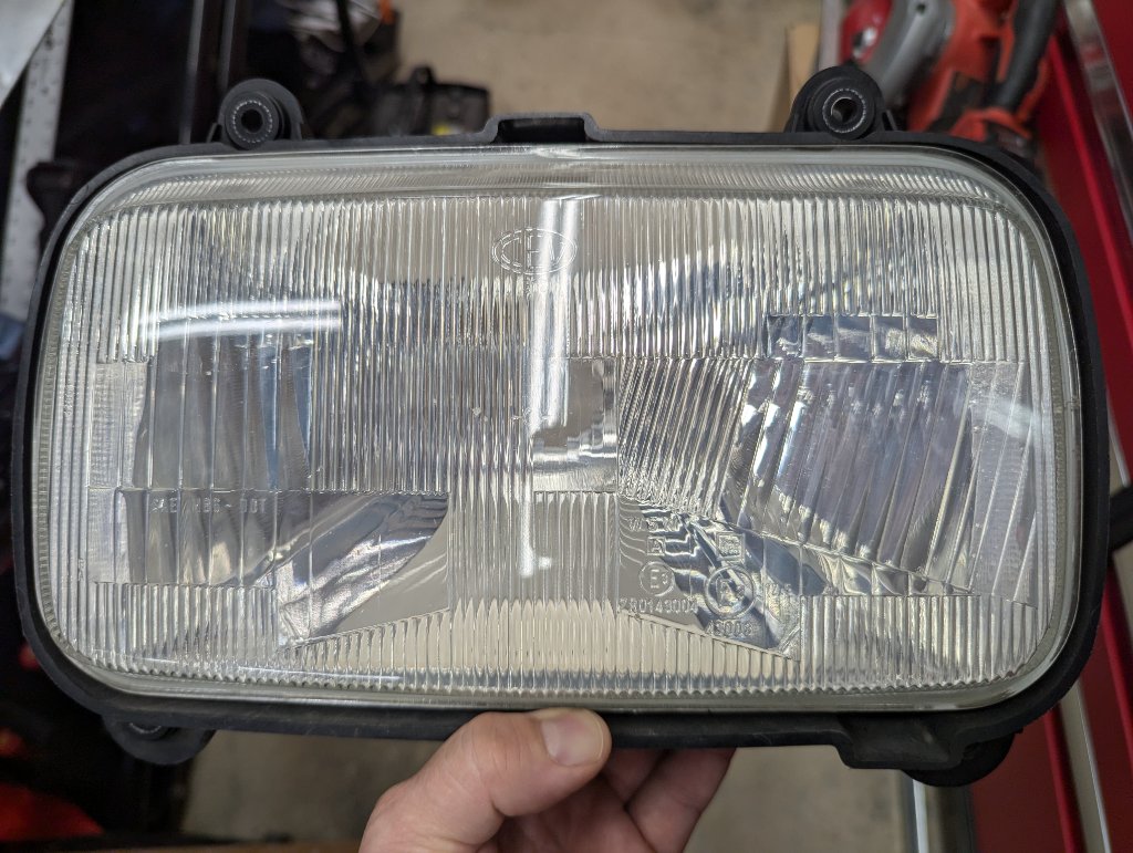

One night I went down the rabbit hole looking up these headlights and it seems the later Paso's had the better lens for reflecting the light. Tempted to buy a NOS one I saw on Ebay from a 907ie just because it's NOS. :lol:
I did notice that on this bike it does have the extra plug at the main beam plug but for the city light, yet this headlight has no provision for a city light. Another one of those things where it has the option for it, might as well use it right?

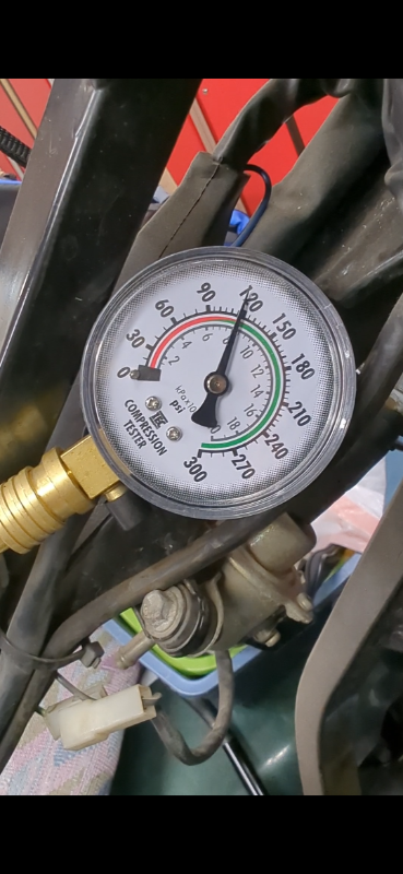

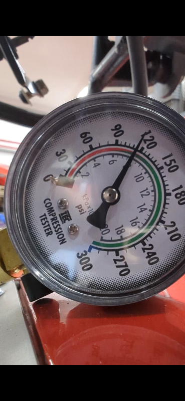

I've since been able to crank over the ignition and get the following PSI readings. Not bad for an engine that has sat for about 18 years! Engine currently is full of oil, and I've occasionally been hitting the start button to circulate it.
Vertical Cylinder
Horizontal Cylinder
