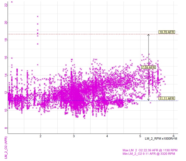

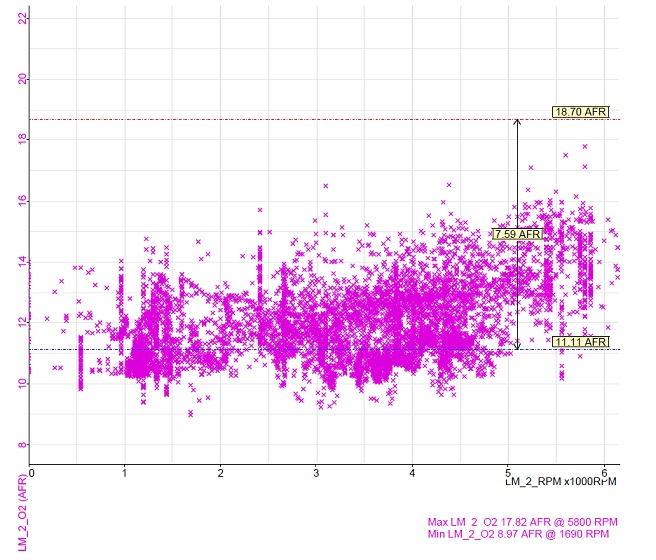

Gents, in the last couple of days I've tried different setups. Got back to idle 65 main 145 and AC 170. Below you can see the result. Rather rich overal with some stumble around 3k. Surprisingly the engine reacts a lot better than the 56/165/185..
Due to the bike response it seems I'm on the right path here. Changing the idle doesn't make a lot of sense as the AFR is rich overall.. I was wondering what should happen if I only adjusted the AC. Theoreticly it should give air during idleing and in higher revs. Below the setting 65/145/175. The AFR is a bit leaner then with the 170 AC's:

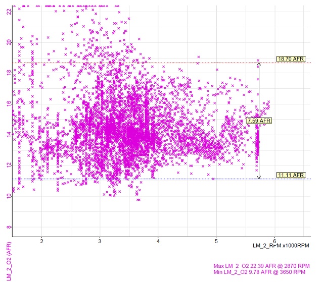

This morning I tried 60/145/175. I have to say that the bike is stonecold during the testlap, while the two above were done with a hot engine. The rich stumble at 3k is allmost gone. Maybe when driving it really warmed up, it wouldn't be noticable at all.
