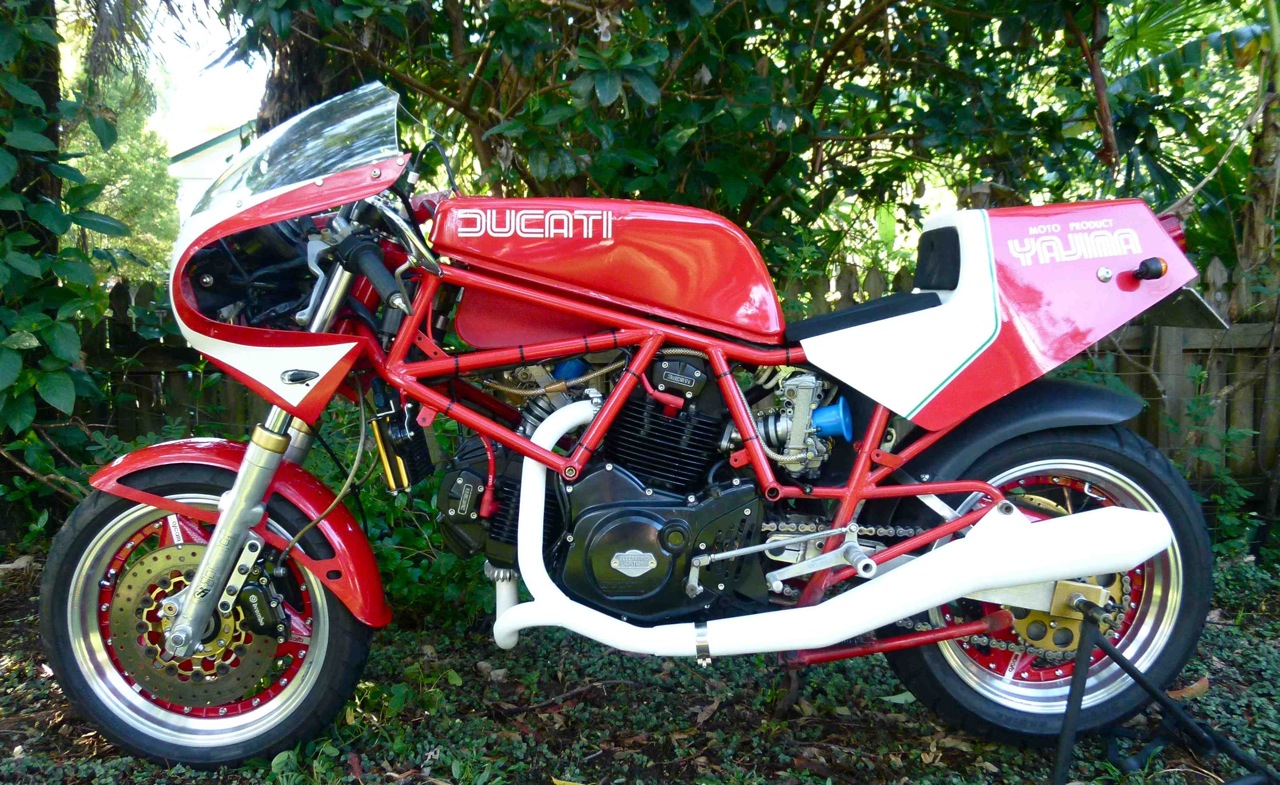

those rims I have put a lot of time into, in fact the front had to be disassembled
and some goo and an o-ring put into it as the spanish factory must've assembled it on
friday afternoon and it leaked air everywhere!
the rear floating brake hanger is handmade (and originally for an F3 260mm disc)
and the rear disc is from a 750 sport so I had to machine 5mm to just get it to fit
Andrew if you look at my profile now we may not be so far away from each other....
Sean

Oh and by the way this bike is for sale so if anyone is interested, drop me a line.

I thought you may have been in Australia somewhere Sean.That is a beautiful bike.Based on an F1?.Where did you get the seat unit from?.Are those carbies Lectrons.

Here are the specs and extra photos Andrew. F3400 base machine. muchly modified

Very nice indeed.Makes me wish I still had my F1customhead wrote:Here are the specs and extra photos Andrew. F3400 base machine. muchly modified

yep...1987 F1 was my first ducati and that got sold but dont fret...they can still be found!

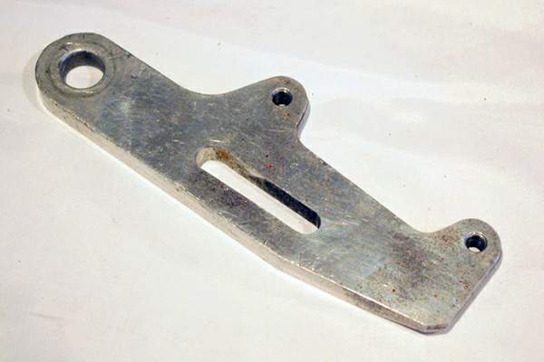

I meant the front one. It looks like thisthe rear floating brake hanger is handmade
- 066080050.jpg (19.22 KiB) Viewed 12442 times

That looks nice Sean, I too have always wanted an F1 or TT replica of some sort. Mind you I'd be happy if I could get a nice proper single seat tail for my 900. Looks we are pretty much neighbours, I'm in Gympie.

Hey Grand One, that front piece is hand made too.
and fester do you need a seat tail for a 1989 900? I have a couple of 750 sport seat tails...

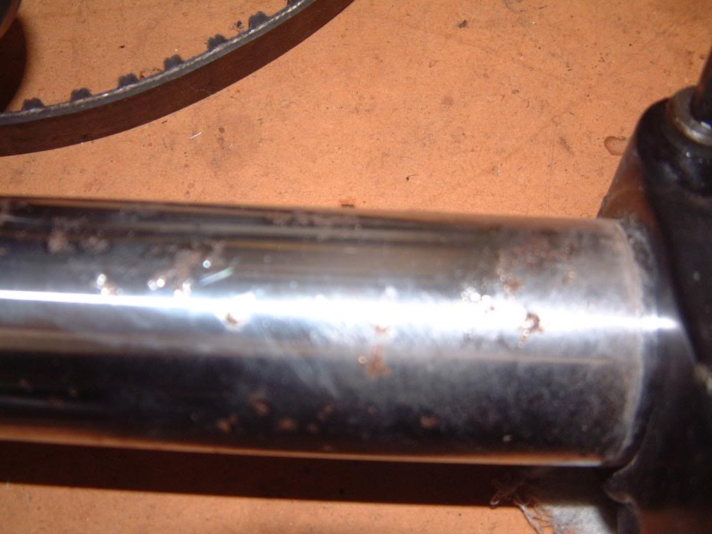

The fork tubes have a lot of rust spots on the front of the tubes.
That's a nice clear photo of the bench
I can't afford new legs at this stage so a clean up with 1000 and 1200 wet and dry will have to suffice for now.I'm aiming at removing the high spots and hoping this will stop the seals from tearing.A polish then turn them around and see how it goes.
I'm going to clean up the fork tubes and give them a paint at a later stage.
