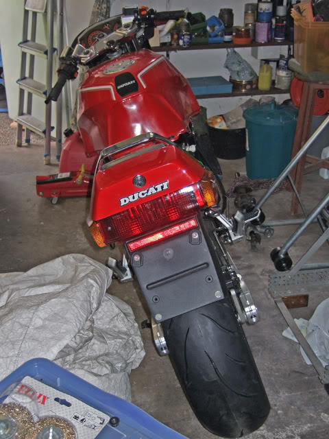

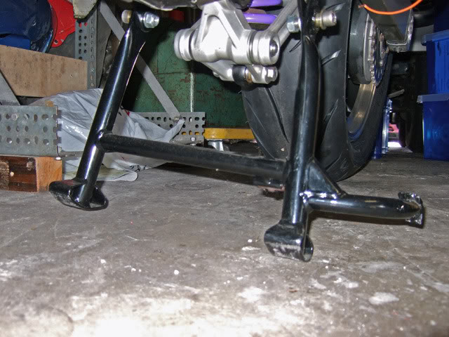

Talking about the side and center stand. This is my bike with the 180/60 Avon when the original swingarm was still in. Only one foot of the center stand touched the ground. On the side stand the leaning angle was quite extreme.
