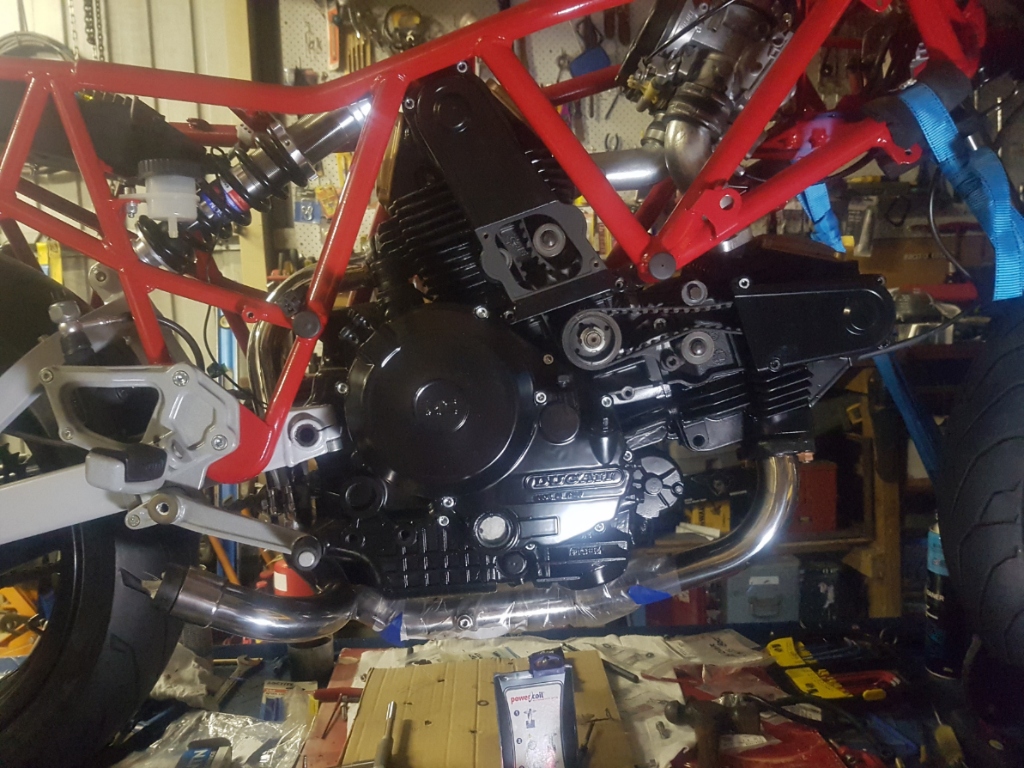

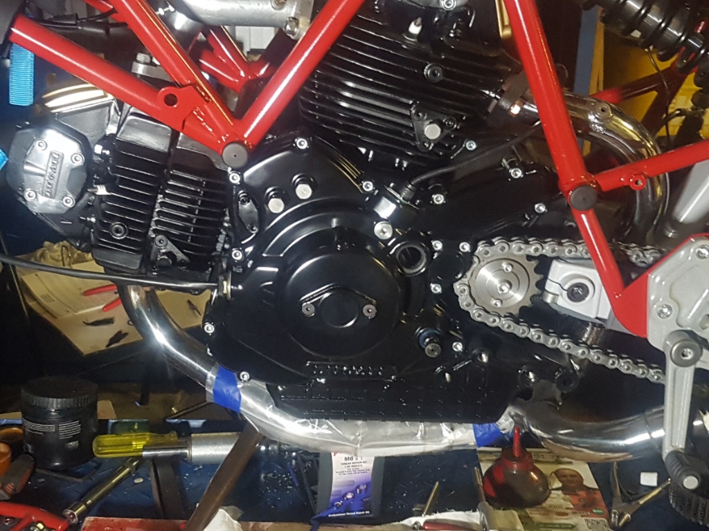

Both covers on and after a last minute helicoil on clutch side I'm really happy how it all went together, clutch internals are not installed yet just setting the gasket

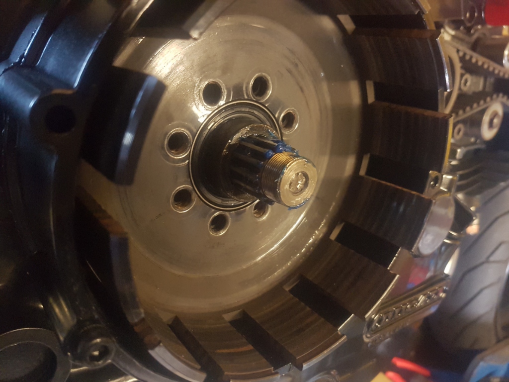

Is there a certain grease for this job and like Paso 750 said is that a broken bolt in the end of the mainshaft ??

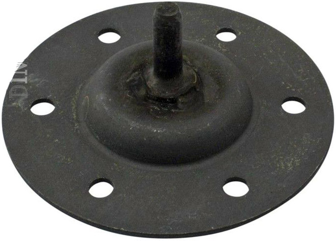

Does your clutch pressure plate still have its guide pin on the backside? That should move inside the shaft. Hopefully it didn't seize and someone managed to break it off.

Yeah the grease is just a wheel bearing grease and the guide is broken in the shaft , I tried to drift it out the other side but she just went in about 15 mil and stopped , I believe it should push out either side, any ideas for this little hurdle?
Re: Oil leaks 89 900 ss
With the shaft sitting between bearings it's not ideal to use a hammer but I guess there's no other way. Due to the oil seal applying heat is also a bit dangerous. Can you get to the opposite side and drift it out from there using a long threaded bar or something like that? It's sure easier to push it back out than fully through the shaft. First I'd spray good penetrating oil on it and let it sit for 24h. Then try again.
What I'm wondering is how long the guide pin is and how much way it requires to move. Maybe the 15mm you have now is sufficiant and you can let the broken pin as it is. As it's seized it shouldn't go anywhere.

Maybe it could be knocked out from the other side using a pushrod from a later model that has the external slave cylinder on the opposite side?
You could drill it out with plenty of grease in place to try to keep the swarf captive but could any of the drillings get into the gearbox from the cavity through the shaft? I don't think so.
