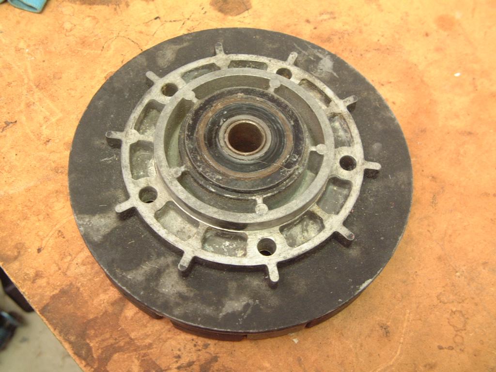

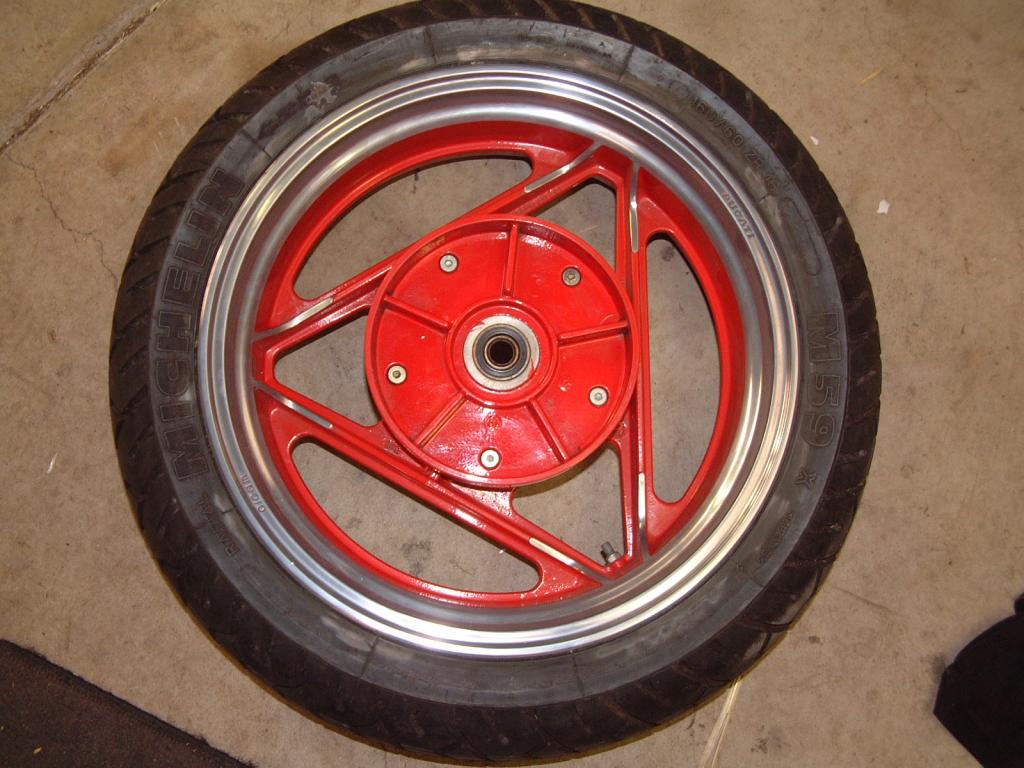

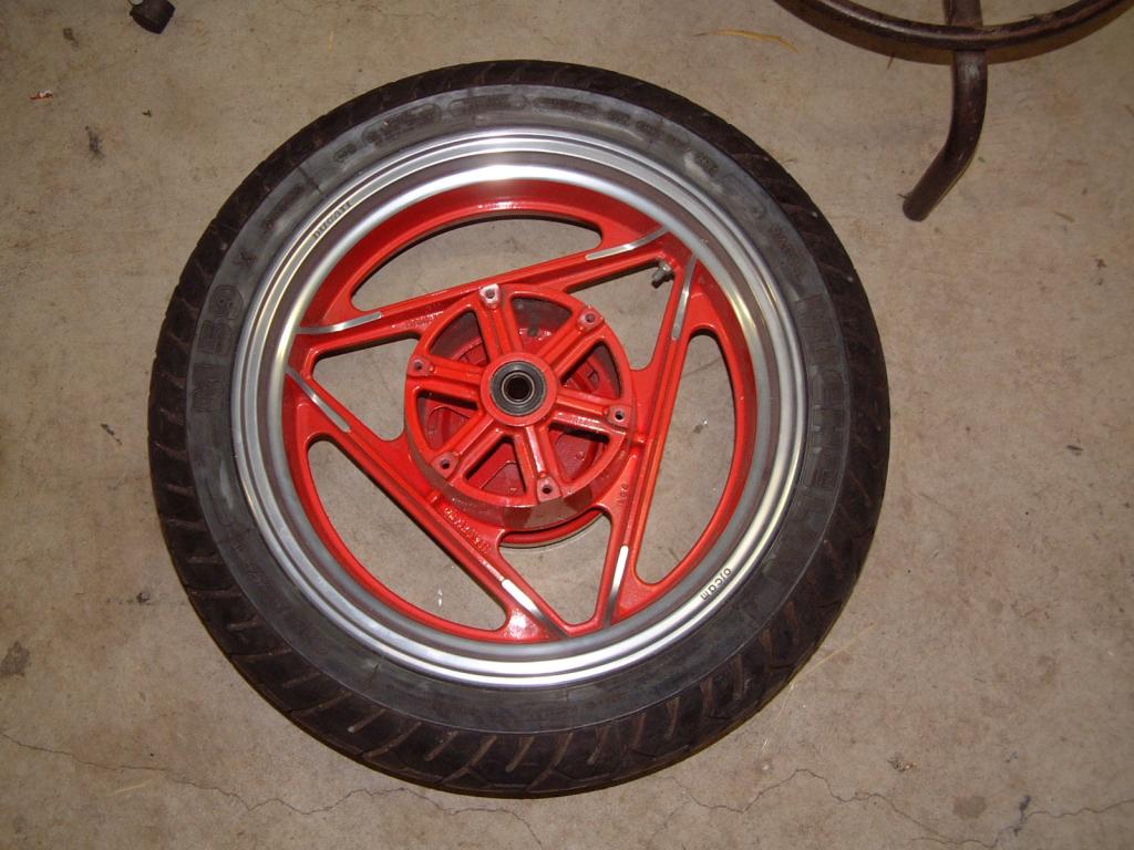

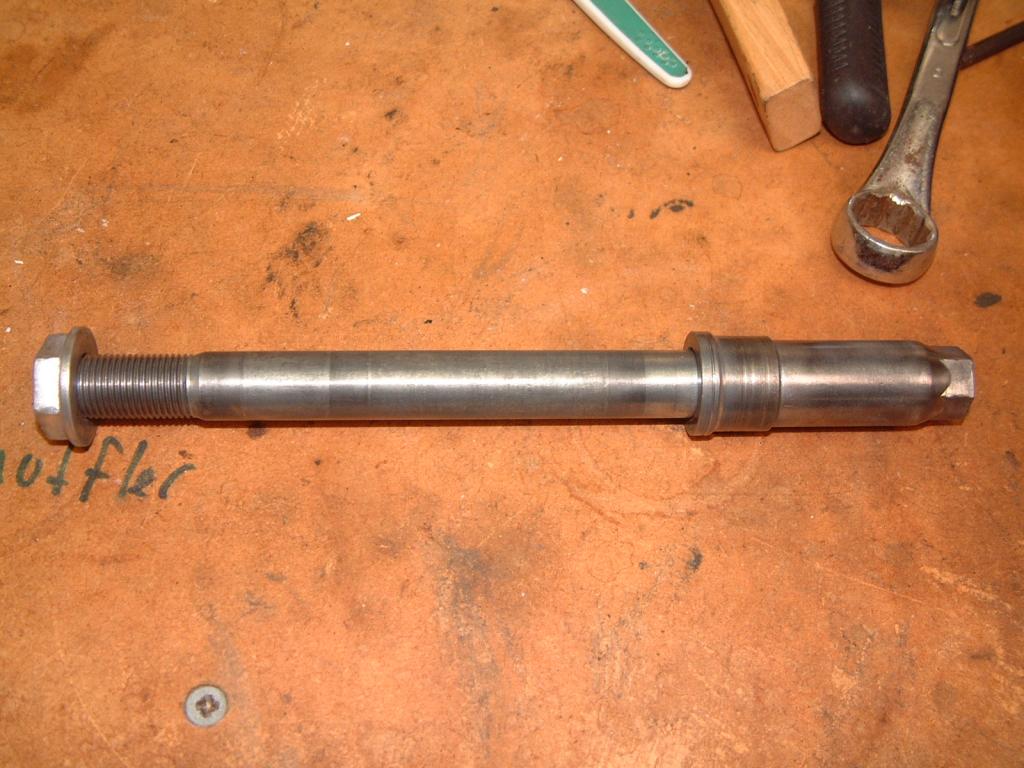

A little help please.The washer in the image below.
According to the manual there should be a washer on both sides of the rim but I only took one off.Can someone please have a look at their front wheel and confirm if there is one or two and if only on which side it is on.
Thanks
Andrew

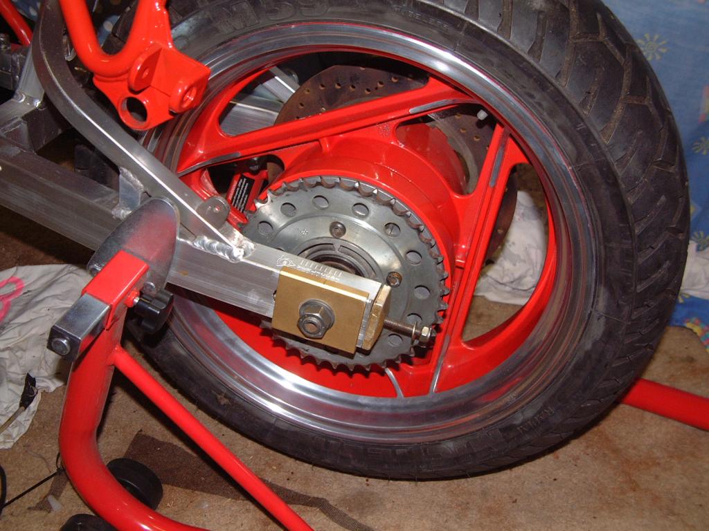

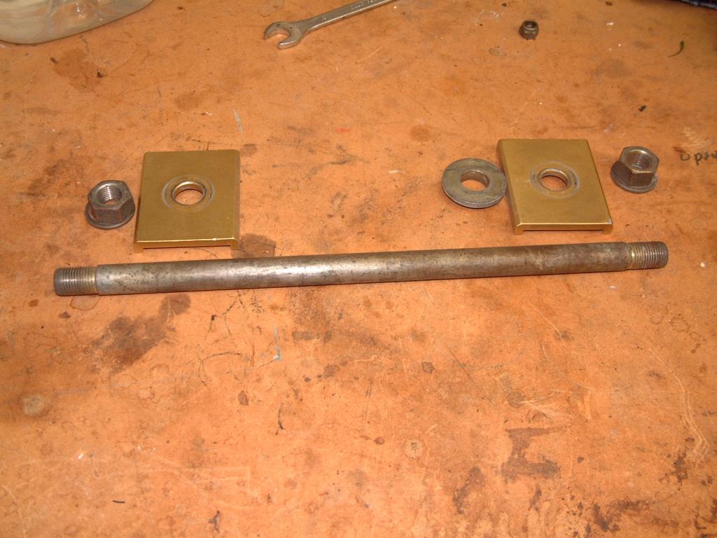

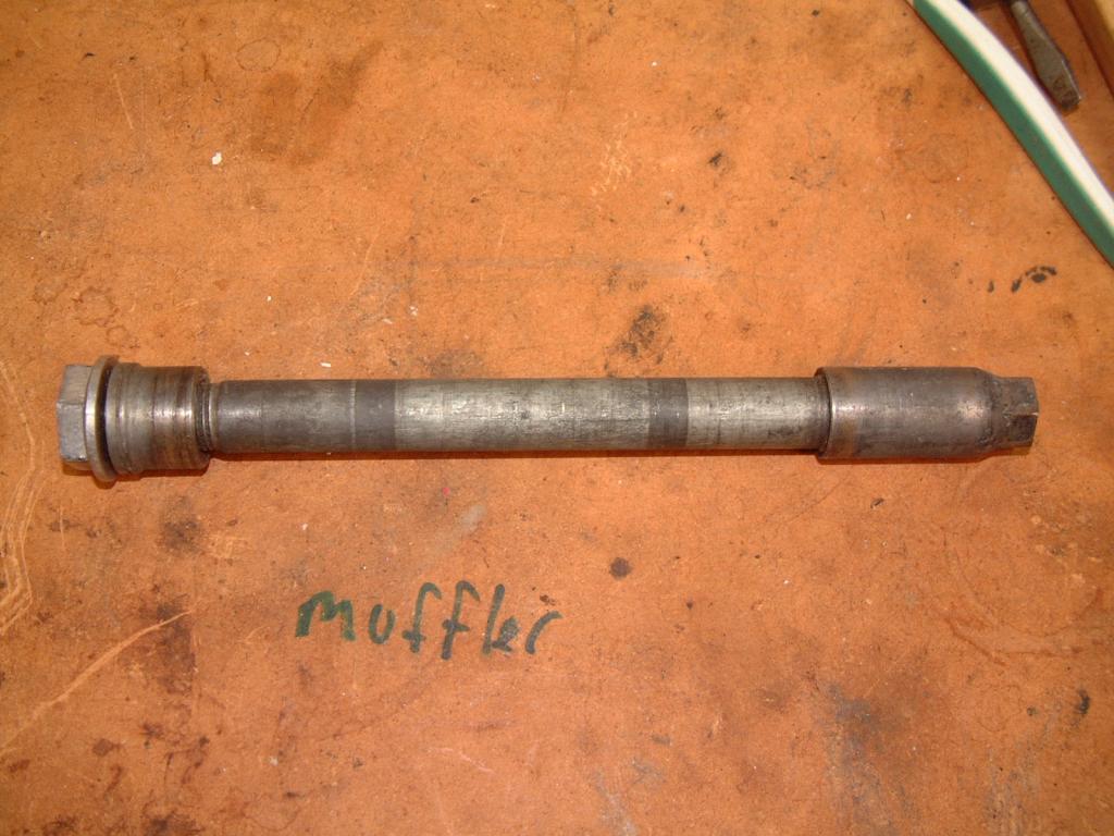

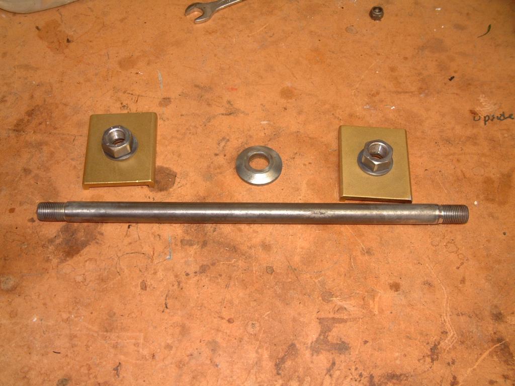

Let's clean up that rear axle.
That's better.....
.....the only problem is it's not a Ducati part.It's the front axle off a Honda XR400 :banghead: .Never mind,it's clean now :lol:
Ok then,let's try again.
A bit better.
I don't think these have been on anything lately.

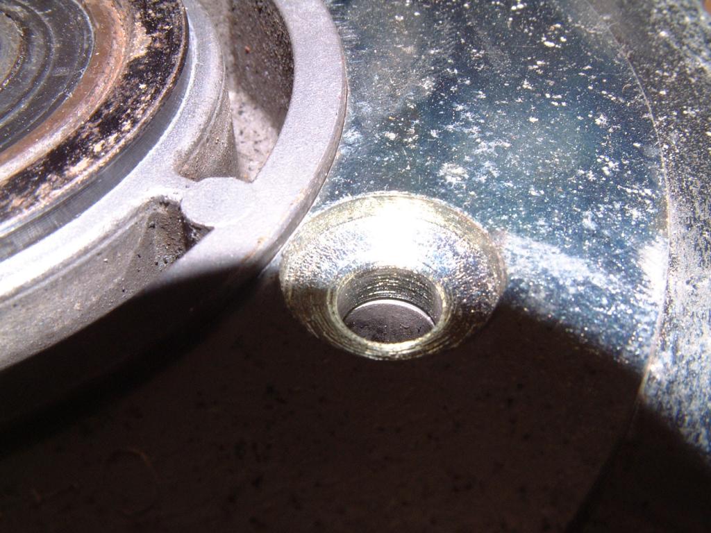

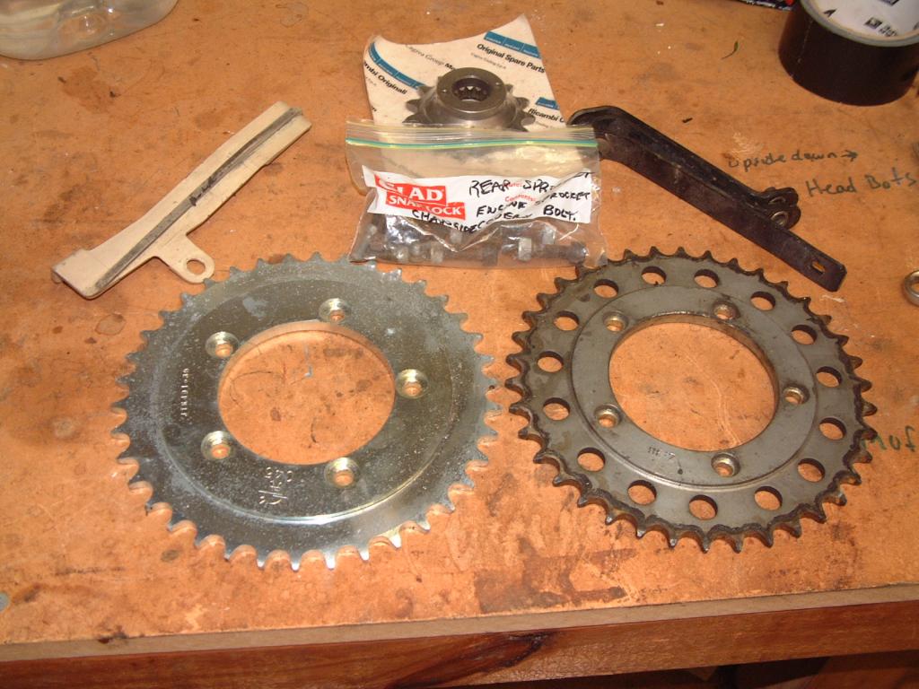

New front and rear sprokets....

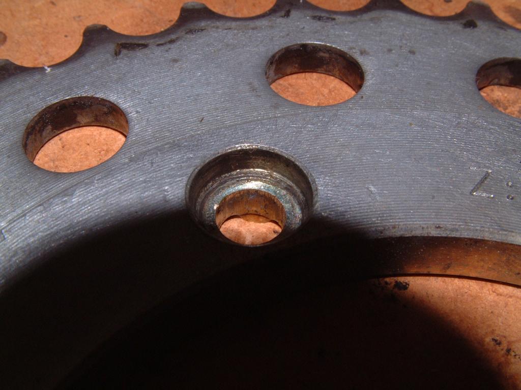

....but I'm not sure about this.The nolt holes on the old sproket are quite recessed.
Whereas on the new one the are shallower and not flat on the bottom.
Any ideas about this.For now I'll put the old sproket on with the old locknuts.

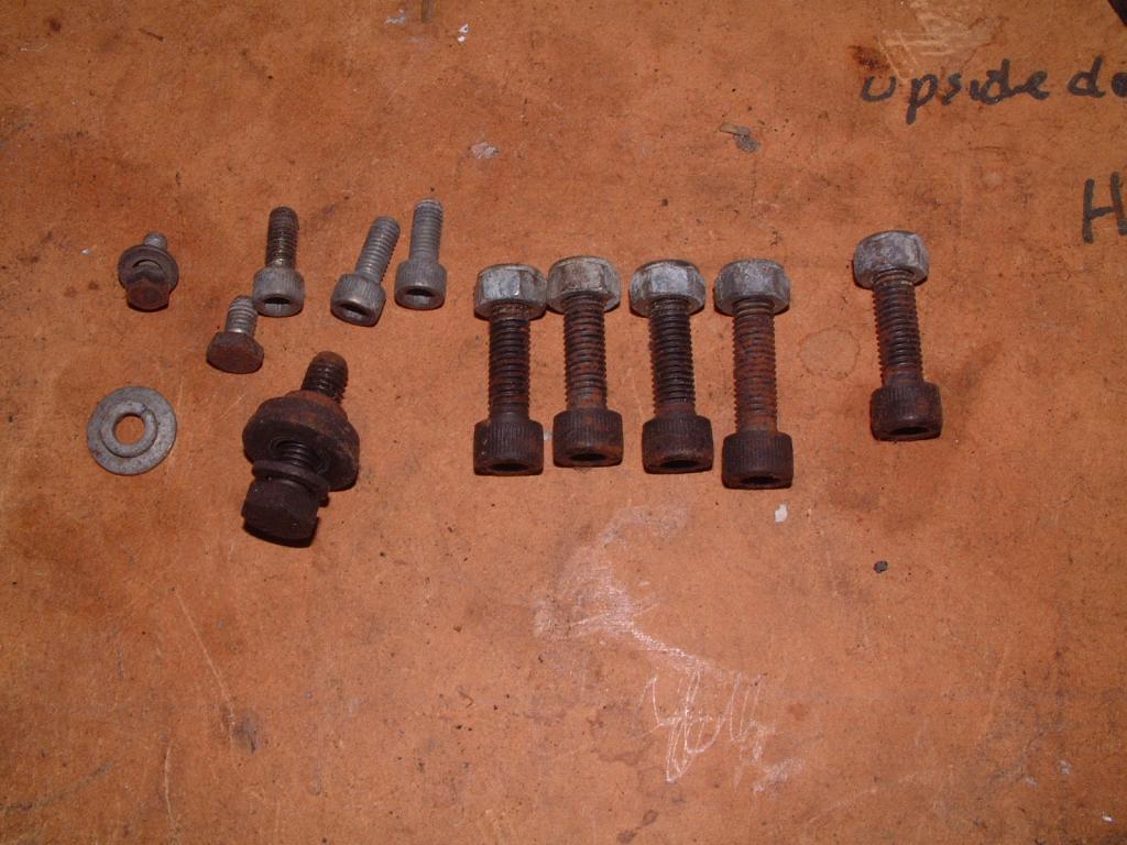

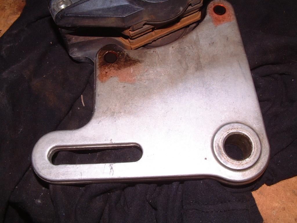

I'll tackle this next.I would have started today but I could'nt get the brake caliper bolts undone.
A bit of penetrine overnight and I'll give it another go tomorrow.I cleaned a little bit and I think it will come up ok.

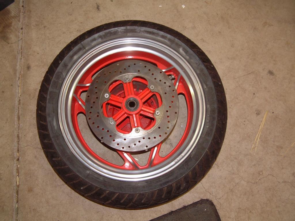

bmw851 wrote:Great job, I've got to write it though, make me happy and get some red cable ties if you haven't already, you don't want to suffer the wrath of G on such an outstanding job.
and if you get red textile tape you`ll eliminate any risk of the cable ties rubbing your paint/powder coat off over the years.
Great pictures Andrew, thanks for the whole documentation. :thumbup:
Instead of cable ties some other things came to my mind when looking at all the photos. ;)
Why not clean those front rotors? All the work polishing the rims and repainting engine and frame and then you will have the rust dust all over. The brake pads could glaze as well. Imho cleaning rusty bolts instead wasn`t worth the effort. (specially if they are gunmetal finished) They will catch rust again in no time.

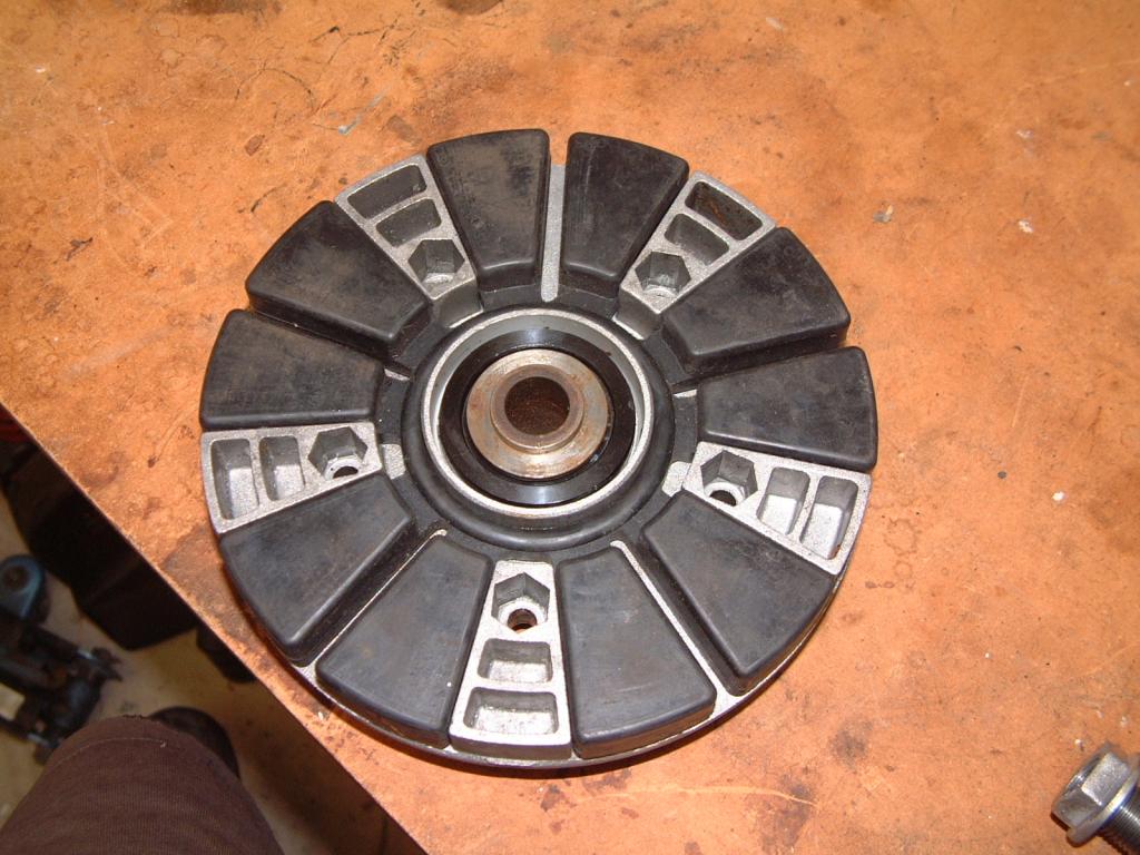

The speedometer drive has a grease nipple and will require regreasing in case it was washed with fuel or degreaser.
The parts catalogue only shows one washer on the outside of the speedometer drive. The second washer is on the other side of the wheel.
If the caliper bolts don`t come loose support the caliper bracket with a piece of wood and give the bolts a tap.

paso750 wrote:
bmw851 wrote:The parts catalogue only shows one washer on the outside of the speedometer drive. The second washer is on the other side of the wheel.
So there are two washers.I only have one which I have put on the outside of the speedo drive as you say.My manual also shows one on each side which is why I asked.I'll have to find another for the other side.Thanks G.

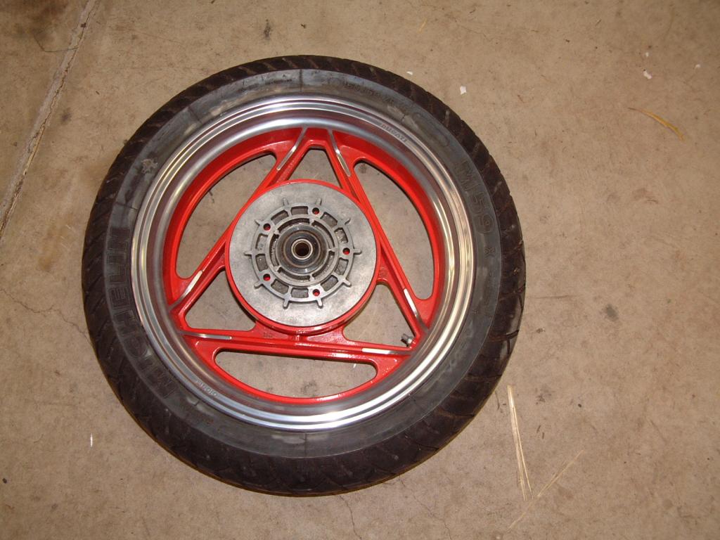

I did actually clean up the disc on the rear wheel but I'm guessing it will get surface rust again before I get to ride it.
Check out the disc on the MHR in the background :lol: .

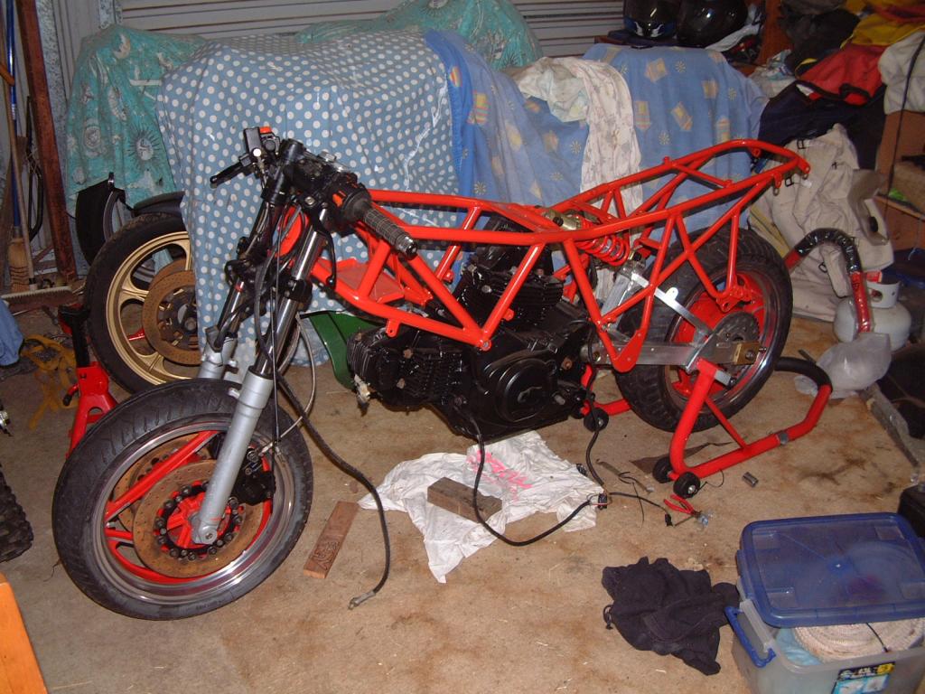

She hasn't had a good clean for a while.
But it's coming up ok.

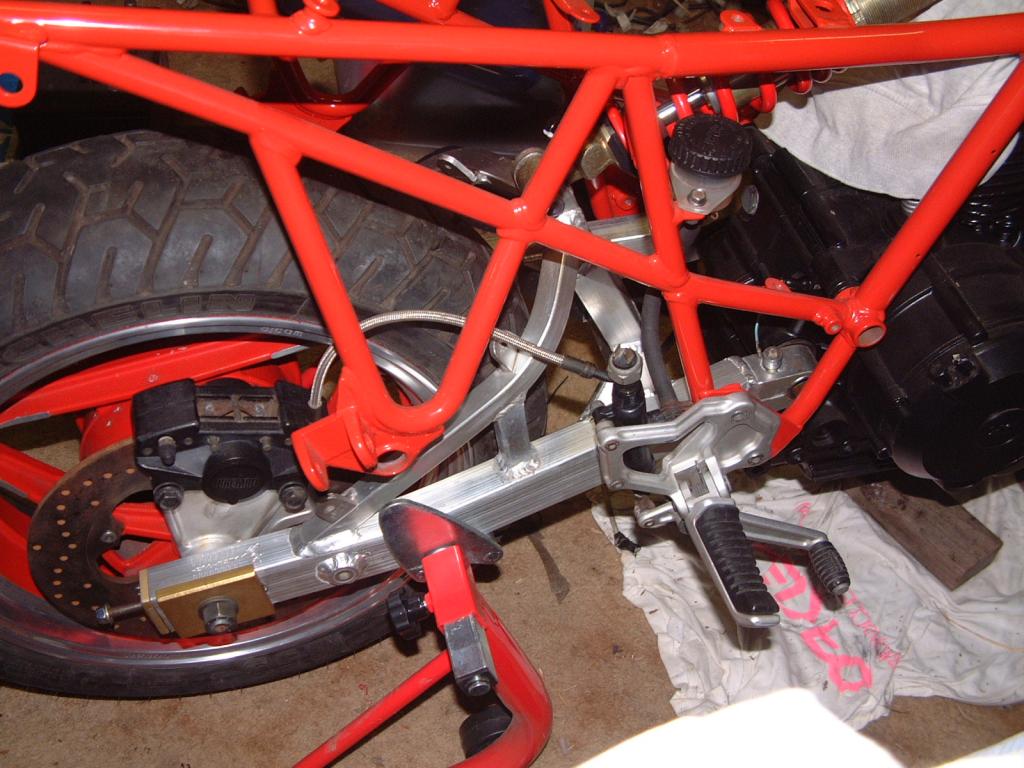

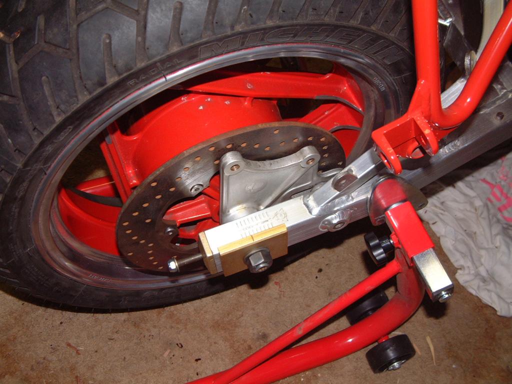

I've now got the back wheel on so It's time to move it to the middle of the shed for better access.

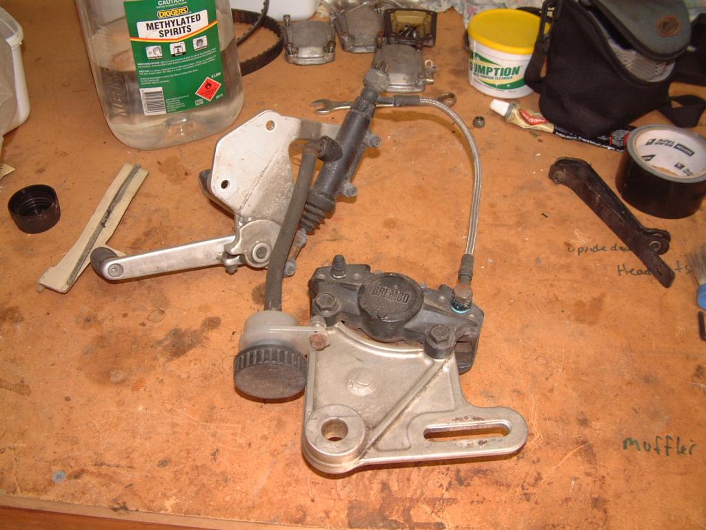

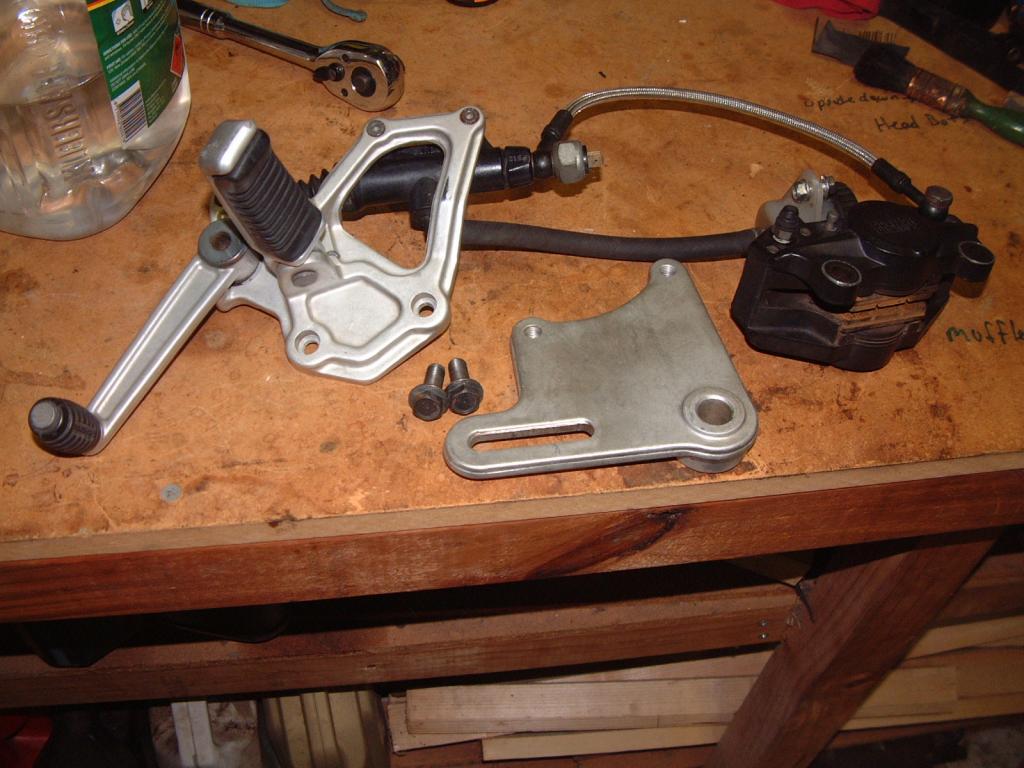

I also got the rear caliper and footrest hanger/controls mounted.
Ready to move.
More soon.
Andrew

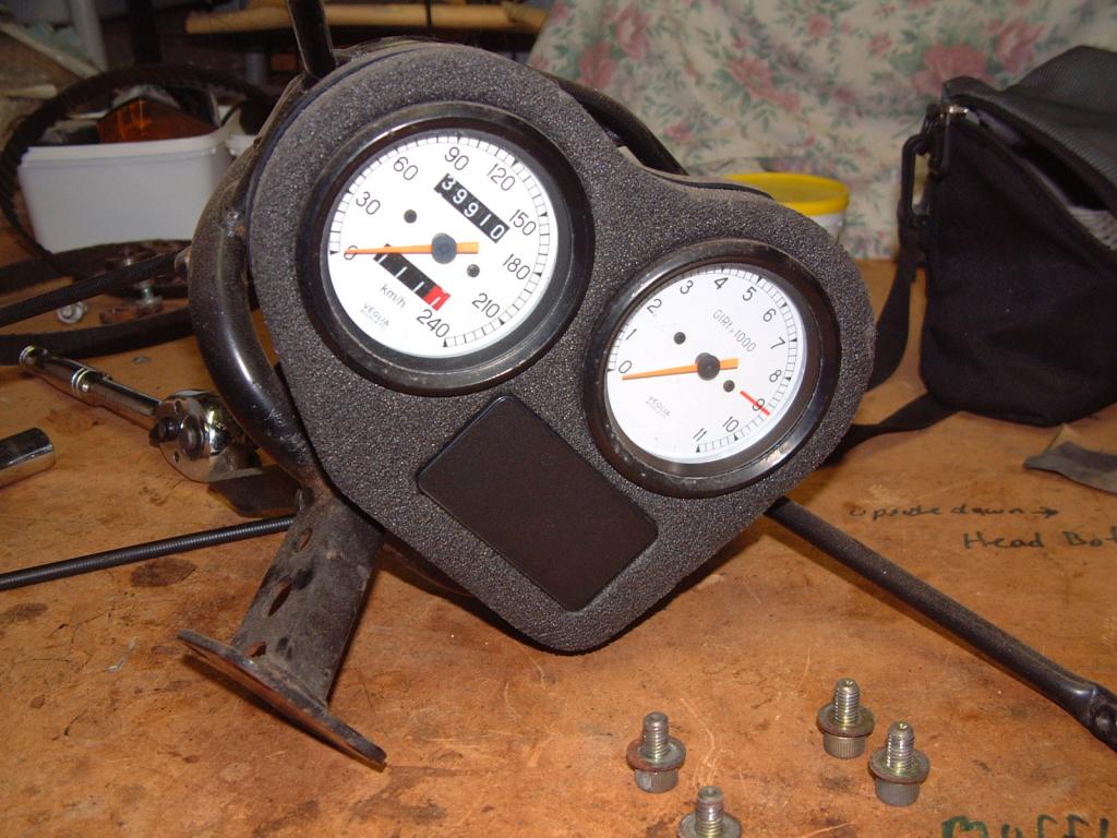

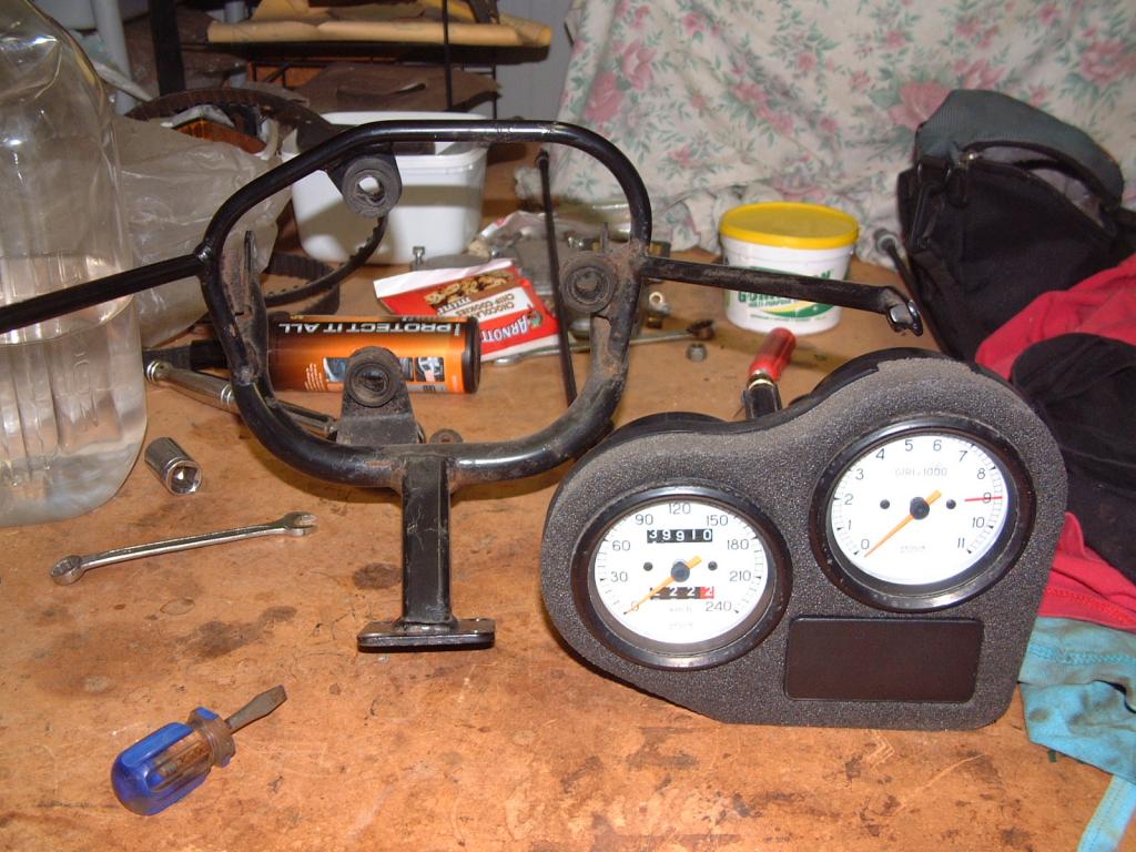

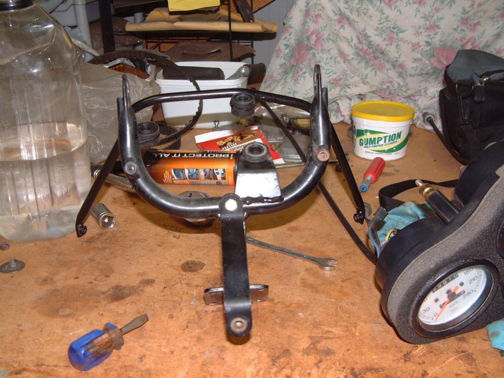

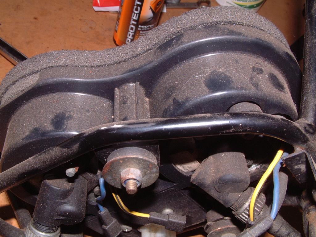

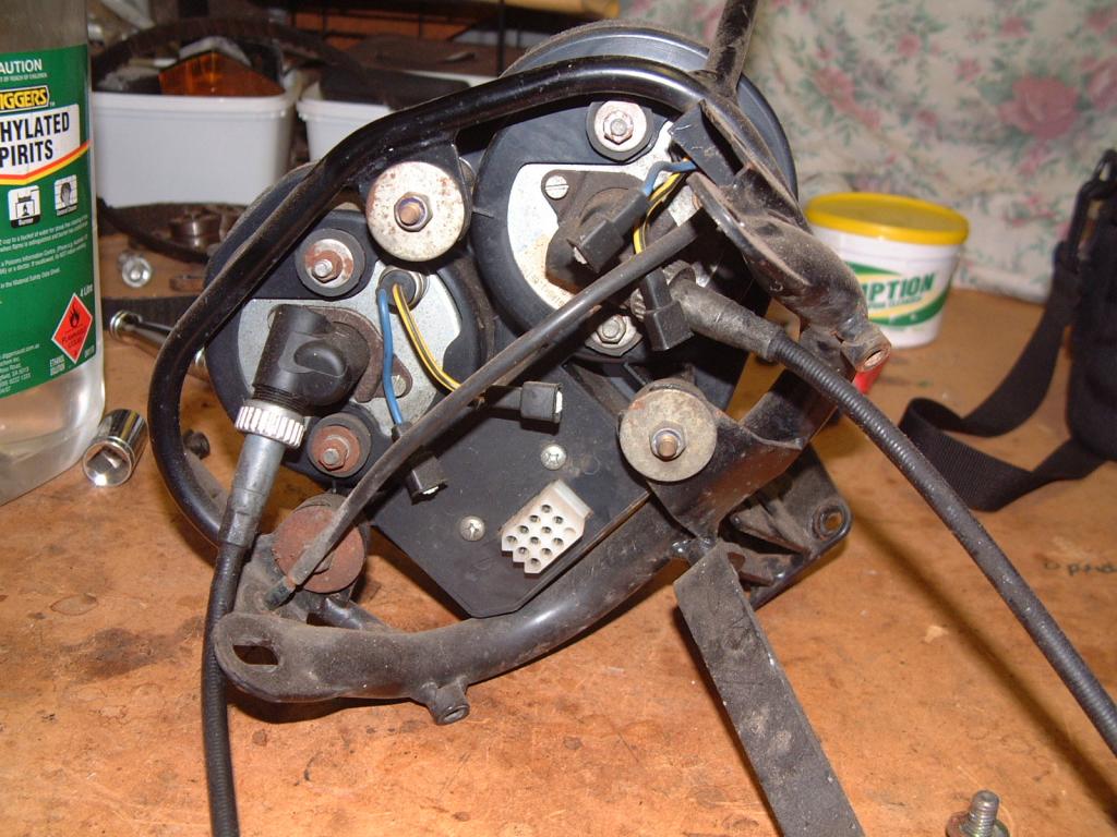

Some serious cleaning needed here.
The paint's not looking too sharp either.
The foam seems ok though.
Best pull it apart and do it right :dunno: .

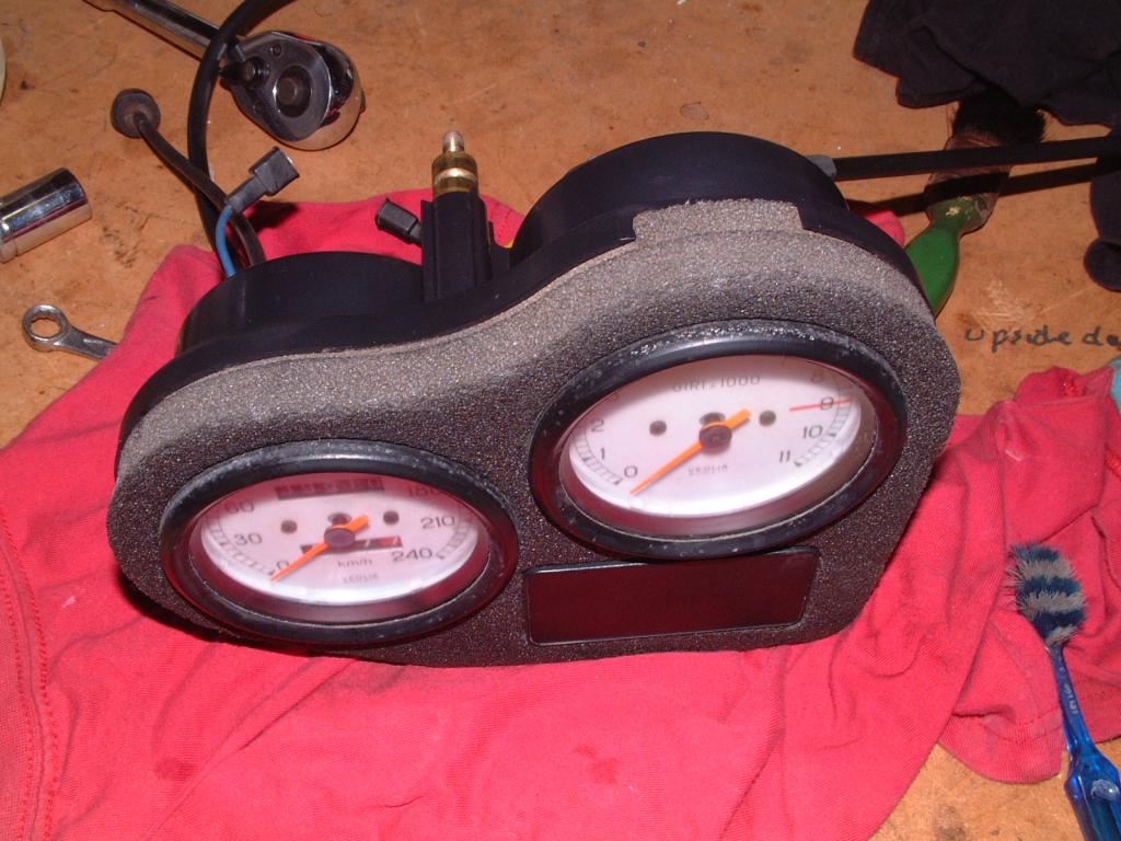

A coat of paint does wonders...
....and the instruments cleaned up ok.There's a bit of paint coming off the clock surround but I can live with that for now.

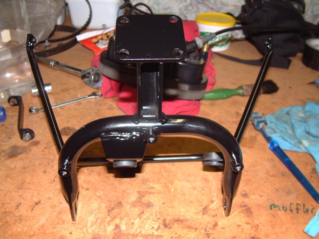

Next....
Not too bad.I may strip it completely and paint the heim joints black.....nah :roll:
Temporarily fitted.
If the paint is dry I'll fit the instrument/headlight bracket tomorrow.Stay tuned....all 3 of you :lol: :lol: .
