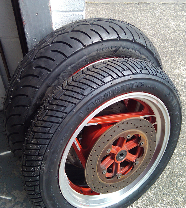

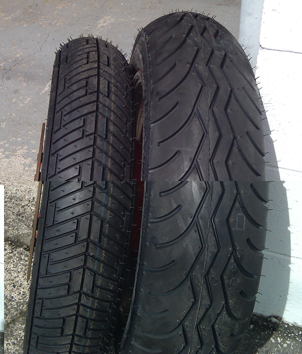

I'm putting Metzler Lasertecs on my 750 Sport. 120/80-16 and 150/80-16.
Front is on, rear will be here tomorrow. Will keep you updated with how it goes.
On rim
On rim
Stretching
Stretching

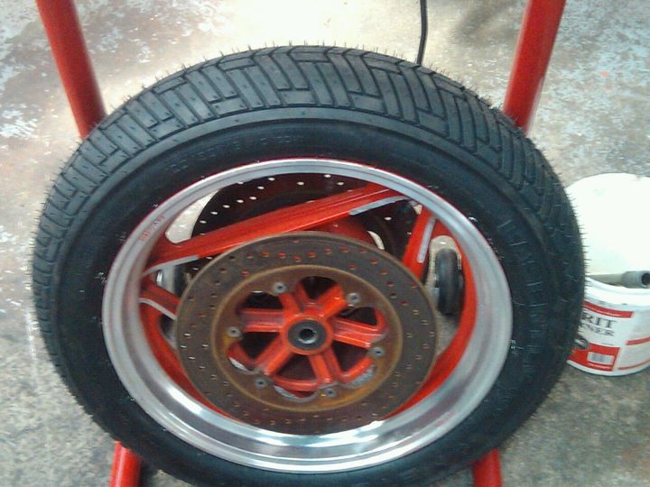

Re: Paso 750 Rear Tire solution (160/60/16)
Post by kiwifruit »
Rear fitted on rim no worries.

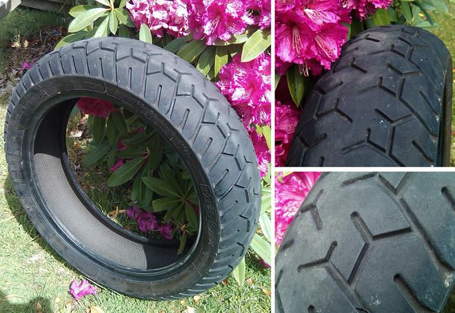

Here is the rear off my 750 sport. Happy to ship worldwide if anyone wants it. Make an offer.
Copy of M59.jpg (76.68 KiB) Viewed 10537 times
