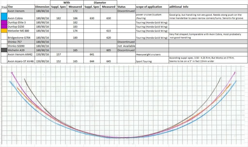

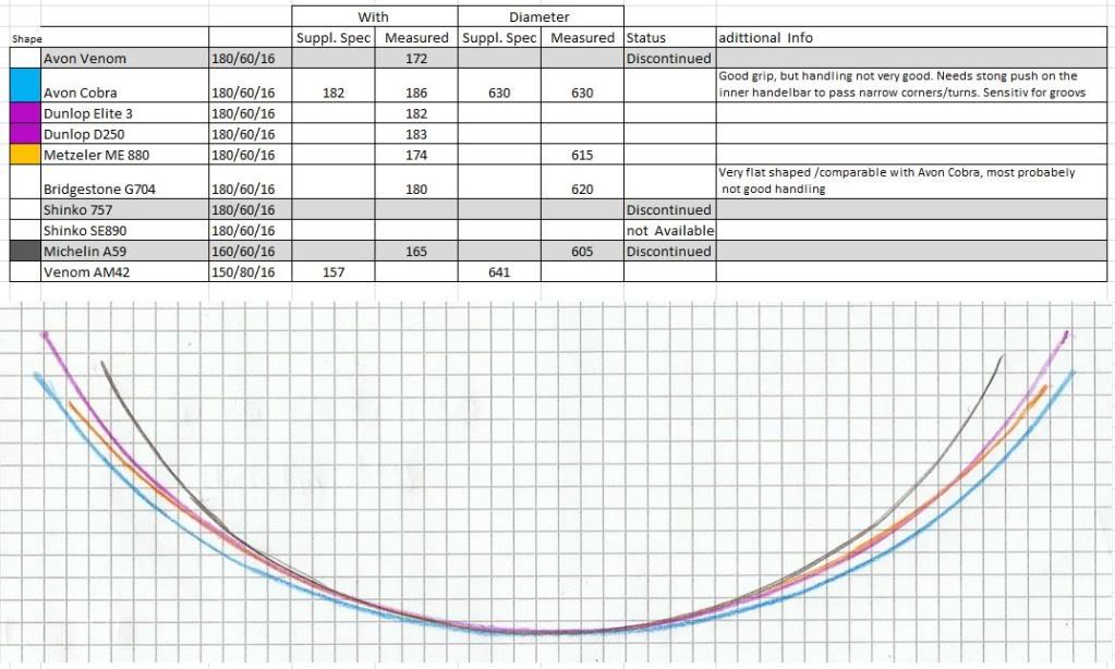

Re: Paso 750 Rear Tire solution (160/60/16)
Hi,
Here the latest tire dimension/shape update.
I’ve colored the shapes to show the differences. The color reference is at the left of the table.
Further Information is welcome. I’m still interested in getting input for the dimension 150/80/16, and also about the handling of all of the other tires (especially Dunlop).
When I got it correct also with the Metzeler ME needs some on the inner handlebar to get it around the corners?
Hi jayh,
Thanks for the input. As already mentioned, I bought a 906 which still has an original almost “new” Michelin. As the geometry of the 750 and 906 are the same, it has to be the tire. No contersteering with the 906.
I still try to get some Input about the 150/80/16 tires. Will decide where to go afterwards.
A 180 looks nice, but I ride more than I look at my bike. So handling has priority. I’ ve still fun doing Quick turns.
No Coutersteering with this combination:
Front: CONTINENTAL CONTI-SPORTATTACK 130/70/16
Rear: Original Michelin (160/16/16)
Below you find the latest dimension overview (news on Avon Azarro 150/80/16; Tnk's Hardo)
cellardoor wrote:Thanks for all the compliments! The Metzeler is riding nice with the axle in the lower position. And yes jayh I have to keep it fully inflated to keep it handling smoothly IMO. jayh do you ride with the axle in the lower or upper position?
What size and model are you running on the front?
I have put the exact same combination on mine. What i run into is that the front wheel touches the front fairing at the bottom when the front fork is suppressed (fi when braking). Did you run into this and if yes, how was it resolved?Ozpaso wrote:I have just fitted a set of AVON Azaro ST tyres to my 1990 750 Ducati Paso. They are a nice fit. I raised the front mudguard 10mm prior to fitting just in case . The chain had to be lengthened a couple of links and the rear sprocket changed to 40 teeth (now running 16\40). The bike seems to handle well, if not better than with the old Mitchelns.
Front tyres
Azaro-ST
Front size:
130/70ZR16 (61W)
Rear tyre
Azaro-ST
Rear size:
150/80ZR16 (71W)
Thanks,
Jaap
Hi Jaap
I am using the same tire combination since 2010. I am very happy and everything works fine.
There are no clearance problems; however, it is a 906 Paso and things may be different (engine size is different, fork is longer) compared to the 750.
I did use a 15 / 40 sprocket combination, but changed now to a 14 / 41, which is perfect for my kind of driving with the Paso. Both combinations fit in my case without any modifications (the chain needs to have 108 links).
I gave some information in the 906 section on the avon azaros and my experience so far with this modifications.
All the best, Hardo
All the best, Hardo
