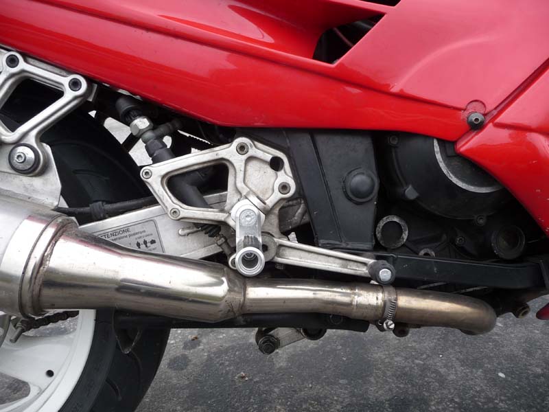

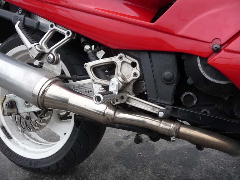

POV porn according to me:
New pegs RH:
New pegs RH:

thanks for the pics Gert...I think Nigel (blazing928) has the same or similar pegs on his bike.

So, no need of modification of the pedals position. Very, very interesting.
I think I'll buy them
- Posts: 1552
Re: Lowering Footpegs
You`re blinded by the mushrooms & Chianti, frankie....So, no need of modification of the pedals position.
But a good risotto is a thing of beauty.
Both pedals need mods, read again.

yes I now have them , purchased from Twisted throttle, I got the 30mm drop and the black peg.
I like the extra grip of the serrated edge, will be safer in the wet.
Gear lever adjusts easy, I thought the brake was ok when sitting in the garage bt on the road the brake pedal is still too high, so I will cut down the rod , as suggested.
I am 188cm, and the extra drop did feel better.
Claude & I rode about 300km on Sunday, I only had a hamstring cramp! Knees felt better.
I also have bar risers, and new grips. I forgot to sit on a sheepskin at one stage as also raising the seat will give a little more room and i think i may get less noise as then the air will hit my upper chest and not the neck/helmet area.
Also will try the 92 model seat as they are mean't to be better than the 91 seat.
