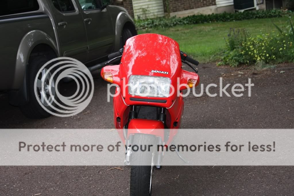

:beer: :beer: :beer:

nice bike higgy but that doesn`t answer the question :mrgreen:
I don`t think there is another small Ducati sticker on the bike. I also don´t think it had a "Made in Italy" sticker. If I`m not mistaking I saw that on the 8xx or SS infront of the gascap.
Did your set come with the "helmet lock" sticker also ?
