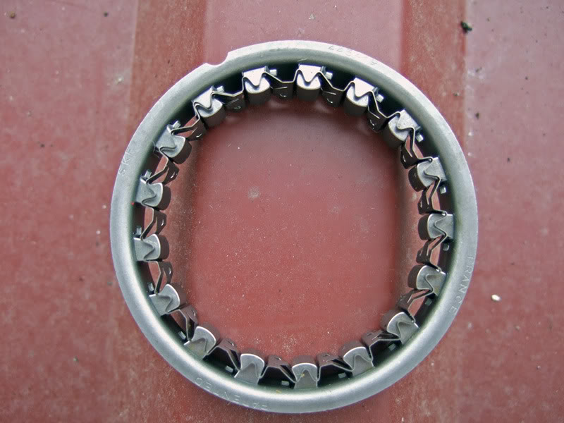

Ok i have had sucess with removal of the Alternator and old sprag, the trouble now is the new Sprag looks nothing like the old "Morse" sprag. My new sprag is a replacement from Bevel Heaven and is SKF Brand. I cannot see any visable problem with the old sprag apart from some wear marks on it and the Spring is still in one piece. With the old sprag there is an arrow which points to direction of rotation i presume but with the new sprag there is no arrow and the only visable difference to one side of it is a small semi circular groove notched into it. Has anyone else encountered a new sprag like this. I am hopeing that i have not been sent the incorrect part.
Re: Left engine cover removal
Could you post a couple of pics so we can have a look at the difference.

The SKF sprag clutch is this one
If you look at the first pic you see that the single elements have one a longer edge. This is the locking edge. Also if you look at the outer ring you`ll see where the gaps infront of the single elements are. So as on the first pic the sprag clutch would run free counterclockwise and lock clockwise.
The part that you`ll have to be careful about when assembling is that you`ll always have to keep in mind in which direction the whole flywheel turns when standing infront of the left engine side. If you look at the rear side of the flywheel trying to figure out which way round things turn chances are you`ll reverse mount the starter sprag
I suppose this is the old type
Yes that is what i have in the new and the old, im sorry but i dont quiet follow your description of the new SKF Sprag but the new sprag has that notch cut into it on one side only is this the side that faces into the Engine?

I don`t have the parts at hand so it`s a bit difficult for me to say.
Take your old parts and check in which direction it locks. (If I`m not mistaking it`s counterclockwise seen from the backside of the flywheel as on pic 14.19a)
The single bits of the starter sprag tilt in the outer ring. If the notch cut faces you and you`d turn the starter sprag clockwise the elements would tilt as shown and the long edge would make contact with the starter clutch gear, hence lock. Turning in the other direction it would run free.
The easiest is to try in which direction the old part locks and then try the new part.
I`d say the cut out notch faces inwards/to the flywheel when you mount it.
I hope I have no thinking mistake
