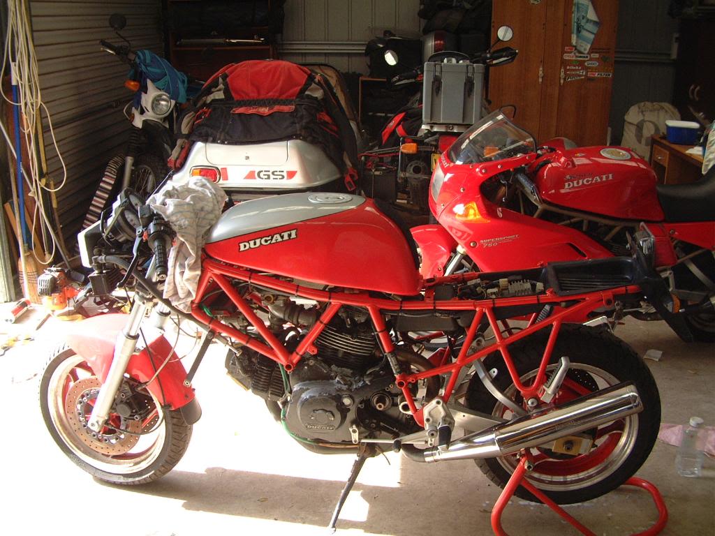

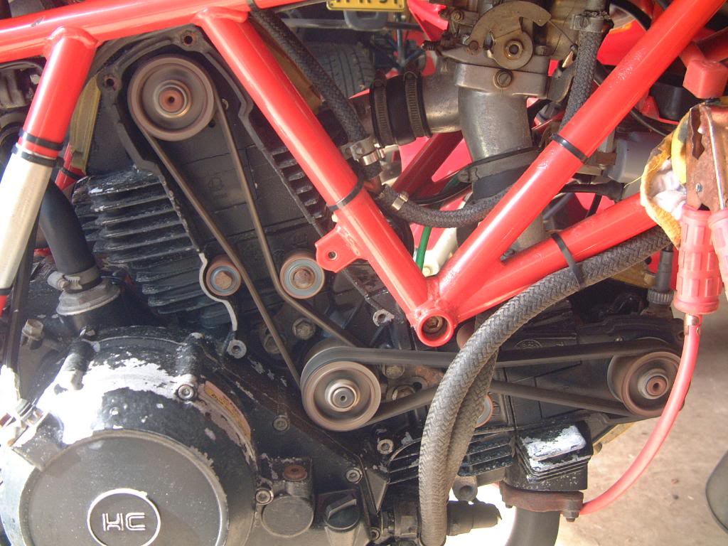

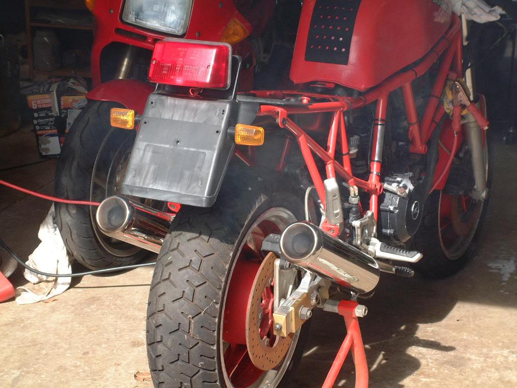

paso750 wrote:It`s painful to see no single aluminium part where the paint hasn`t bubbled from oxidation.![]()
The ground connections don`t look much better. I hope the other electrical contacts do.
Yeah,it's a shame G but it's fixable with some time and effort and I'm in no hurry.I don't know how people can let their bikes go like that but we're all different I guess.

As G. pointed out, with all that corroded aluminum, you will need to spend a considerable amount of time on the electrical connections.
Andrew

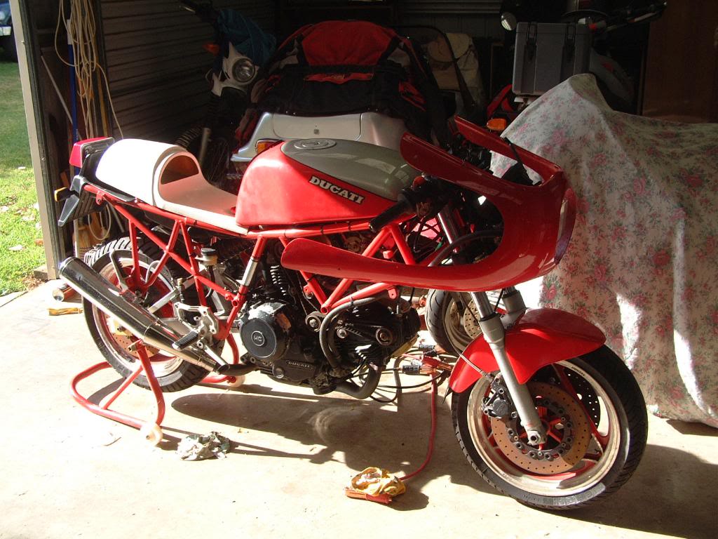

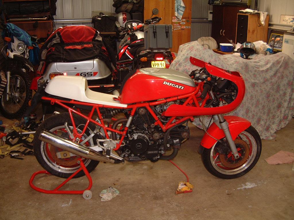

It's been a good day...so far.

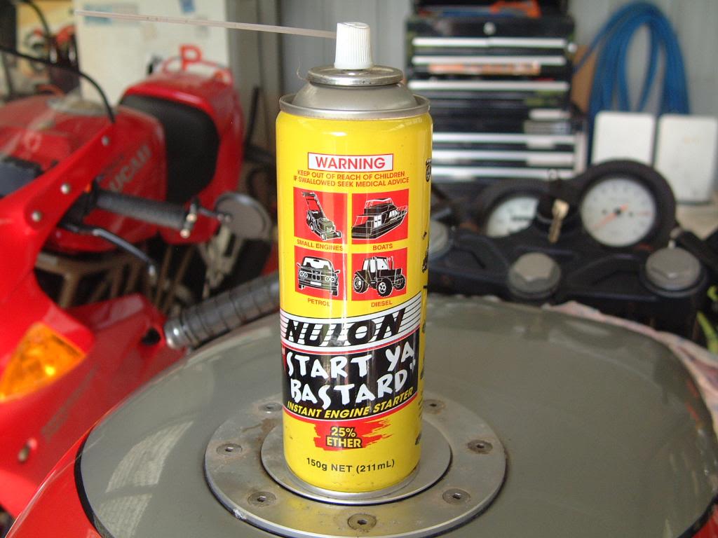

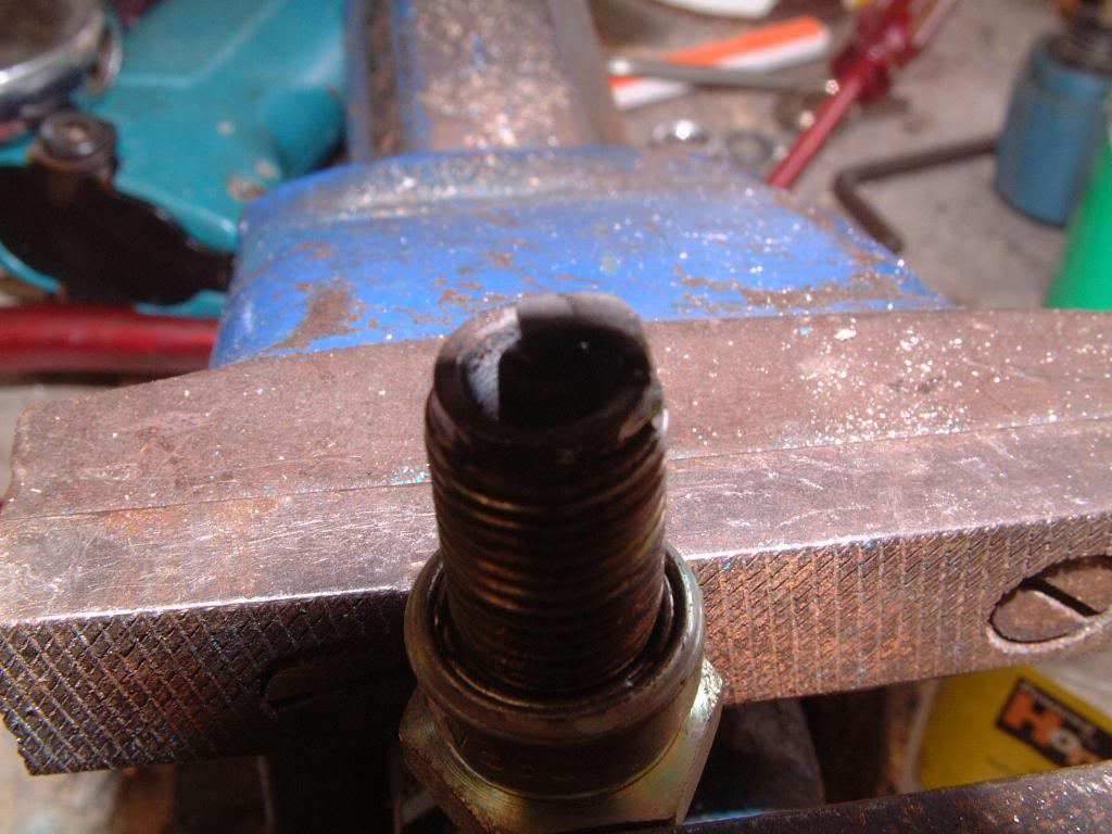

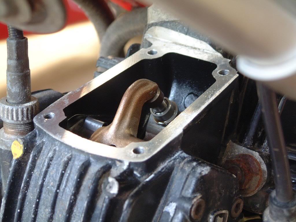

I started off by spraying some carbie cleaner down the..um..carbie.Then I sprayed some more.Next up I removed the valve covers and spark plugs.
The paint on the valve covers is'nt the best
I applied copious amounts of fresh oil on the desmo gear and some down the plug holes.The plugs were a little dark.
Next up I turned the motor slowly to get some oil up and down the bores.On with the tank,connect the hoses and put in some fresh fuel.
A little bit of this.
Connect her up to a battery and.....
...fired up first time.Bloody beauty.I kept the reves down and only ran her for a minute.One thing that did surprise me was how well the Weber carbureted on the few blips I gave her.My Paso was never this good with the Weber.The motor was also very free reving.All good so far.
She smoked a little from the oil down the plug holes but not too much.That'll burn off.
Next up a little play with some spare parts I have lying around.

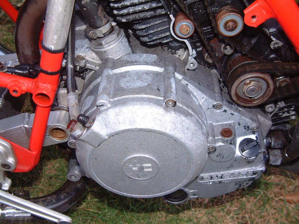

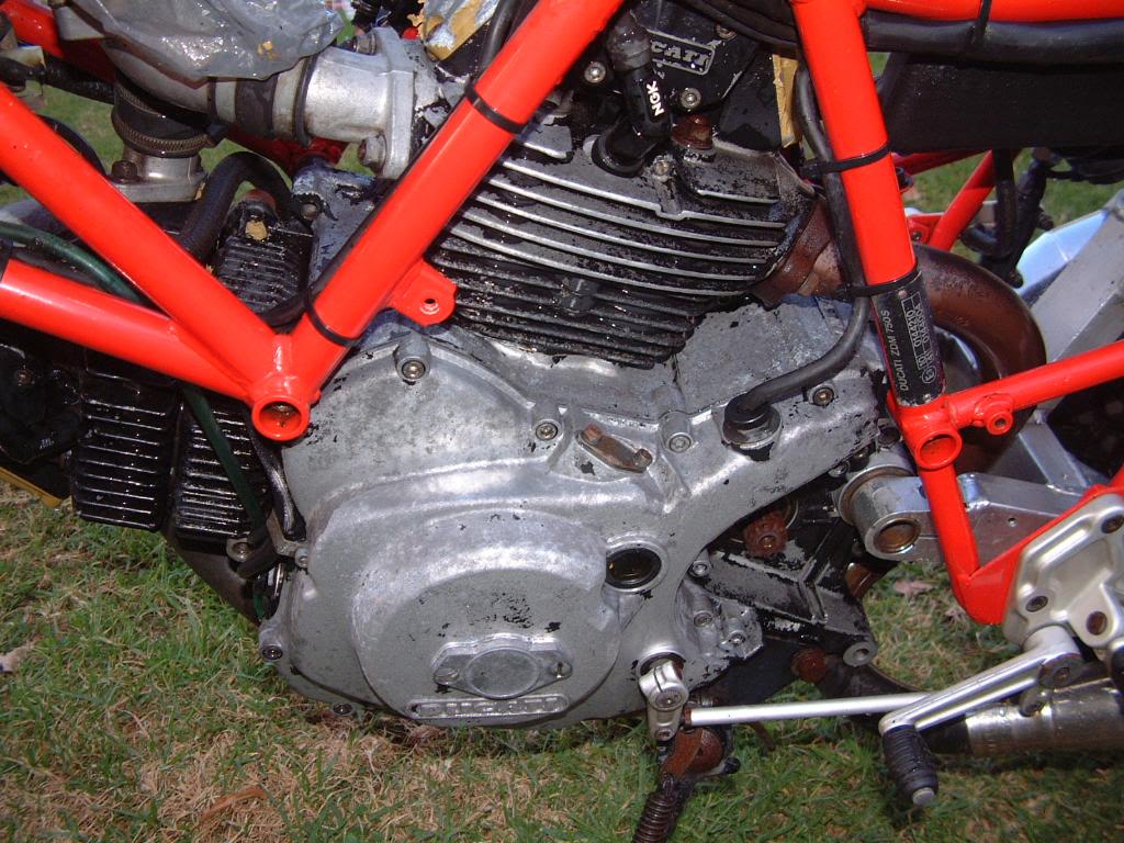

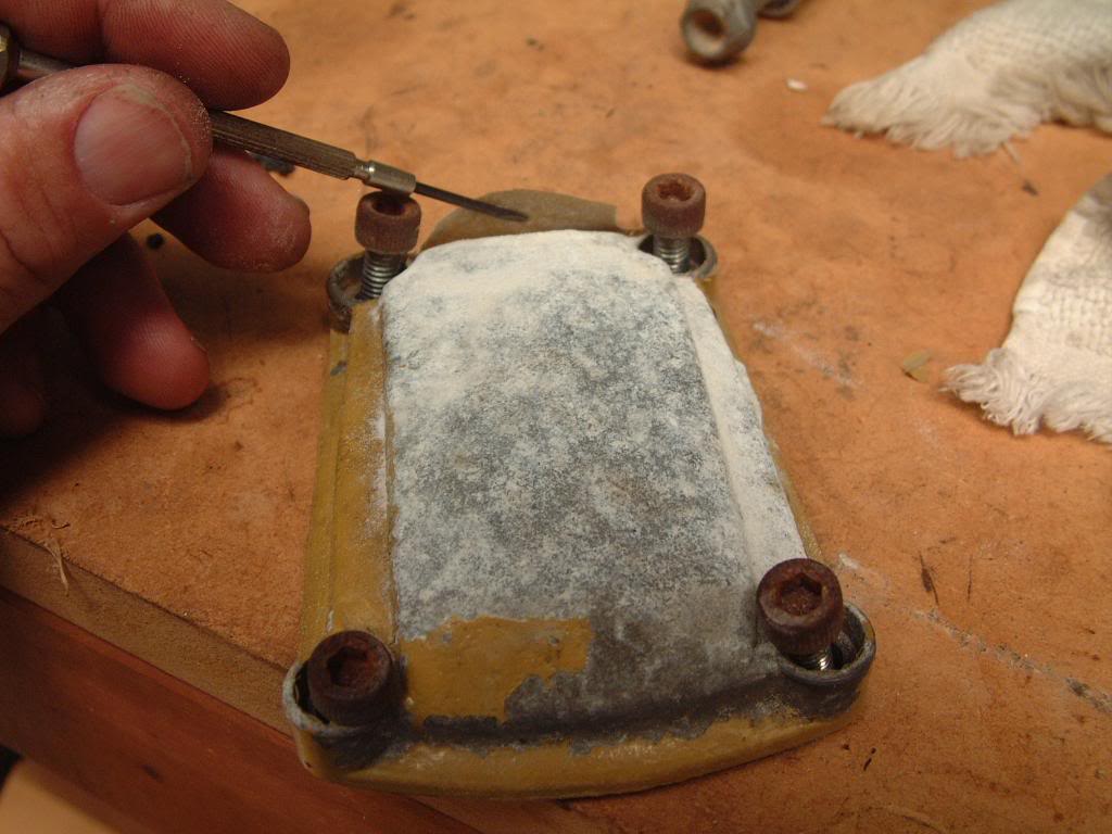

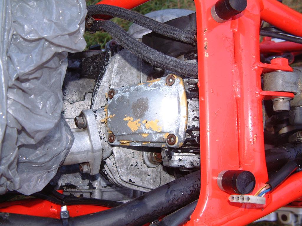

I then spent some time stripping the paint off the engine.Not to bad so far.
The alloy underneath the paint is very coarse and wondering if they left it like to give the enging paint something to bite onto.What would I need to do to get it looking better if I was going to leave with an alloy look instead if painting it?.
That's it for today.I'll probably make some space in the garage tomorrow for all the bits and then start stripping her down for painting etc.
A2

Looks like quite some progress. Being cast parts the surface is a little coarse but it`s hard to say how much corrosion added to that. Keeping an alloy look will be difficult as it needs surface protection. There`s only painting, anodizing, powder coating or polishing. Painting requires a paint/primer that`s suitable for aluminium, not all are. Brass protective laquer will work on aluminium. Any laquer used on aluminium should not contain lead or copper. You`ll also need heat resistant paint at least on the cylinders and valve covers. Anodizing, powdercoating or polishing will require the parts being removed from the engine and the oil window removed, too. Polishing will need quite some sanding to get a perfect surface before starting polishing. The polished parts will become dull over time and need constant care. How well a polished surface holds up also depends on the climate.
