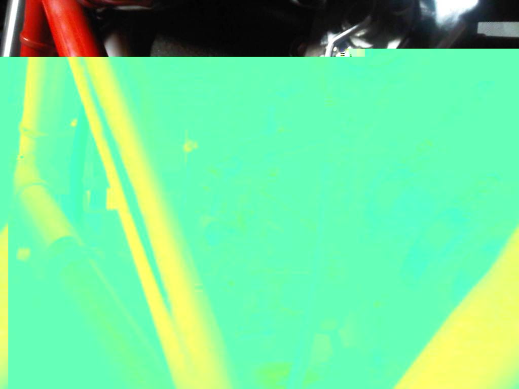

The penny finally dropped on why everytime I ride it, the thing just pops and farts, put the Silentiums? back on that helped some then Uni Filter here made up some pod filters to suit the Keihin's and all fixed, previous owner never rejetted the carbs to suit no airbox and straight through pipes, go figure.
The adapters for the Carbs were not cheap to say the least
This should cheer up Gerhart some :D .
Certainly did me riding it :choo: .
Peter
Uni Filters.jpg (68.17 KiB) Viewed 4201 times

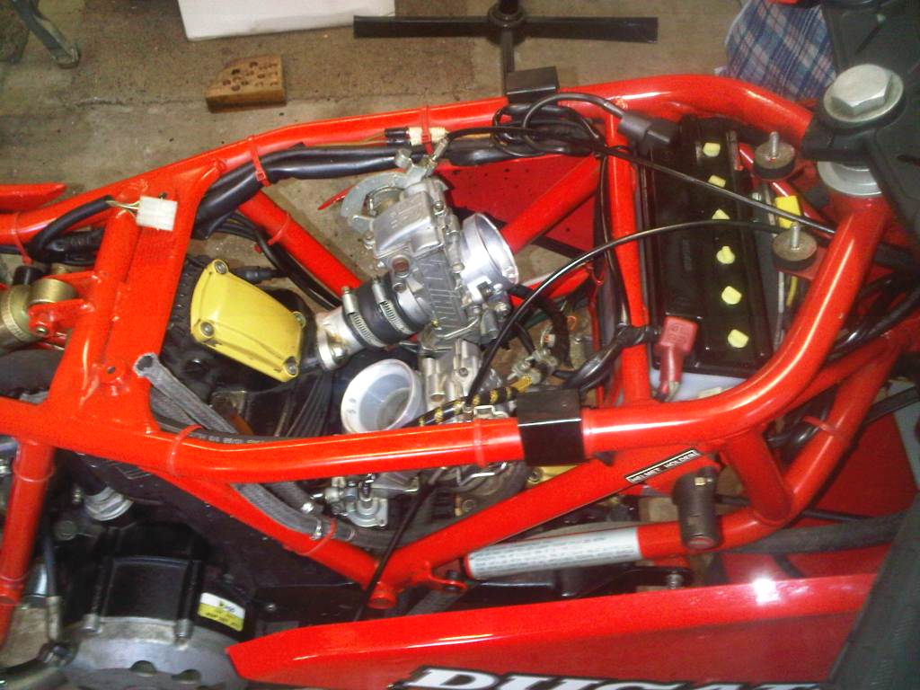

Add a 90 degree boot between the aircleaner and carbs and it will run even better.
bmw851
Posts: 322
model: other
Re: Flat Slide Keihin's
Post by bmw851 »
Thanks Phil, had looked at your setup and was wondering.
When I have the inclination and money, I'll take a stab at rejetting it and getting the Conti's back on.
Peter
ducinthebay
Post by ducinthebay »
Don't need much money. about $10 each, and now it seems they are even on ebay.
http://www.ebay.com/itm/51mm-2inch-90-D ... 786wt_1165
Cheers, phil
