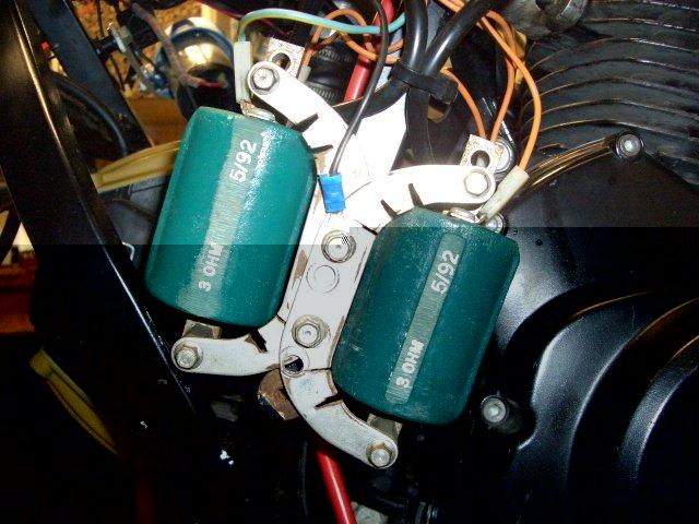

If this will help anyone:
Here is how I mounted Dyna Coils to my stock 750 hangers. A few kerfs cut with hacksaw allowed hangers to be spread to accept the longer dyna's. It appears I moved them up the frame a bit to accomodate differing plug wire connection points from the stockers (the unpainted standoff).
- CIMG0001-1 (2).jpg (64.94 KiB) Viewed 4336 times
