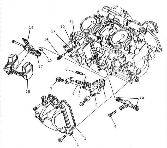

That doesn`t sound to bad, but put on those filters and get the carbs adjusted properly.
It´s interesting that you now have a mixture of a TRX/TDM jetting and a Dynojet kit of a 900SS.
7 is the starter, 6 the main and 8 the idle jet.
When you replaced the o ring on the adjuster screw did you check if there`s still the washer between it and the spring (#12) ?

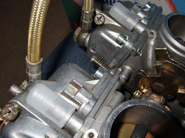

As the adjuster screws are on the front I recommend to find two plastic caps to fit over them. Of course you can also find a rubber tube that fits over it, heat up one end until it starts to melt and then squash it with flat pliers. This should protect them from humidity and dirt and from seizing.

That`s why I said you always need to check all jets and note their sizes and also check if all o rings and washers are at their place. You never know where such a carb came from specially if you get one on ebay. Previous owners may have messed with it, or put a Mikuni of a 750 on a 900 w/o replacing all different jets etc. Specially if you have to rejet due to mounting it on a different bike, having open filters or exhaust you need to know the current jetting as a starting point.... but it turned out there were bits missing!

- Mikuni.jpg (55.03 KiB) Viewed 16300 times
